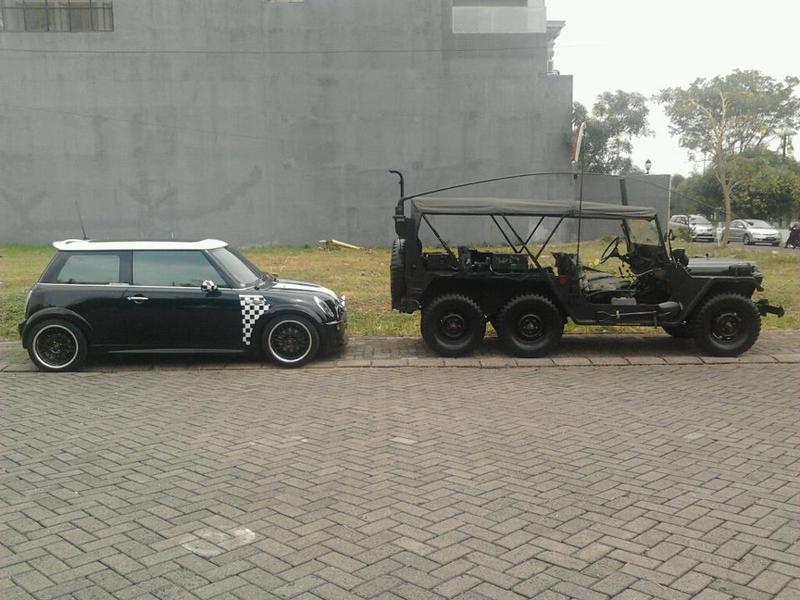

eibach pro kit springs with bilstein shocks here :D
Attached Thumbnails Gallery! Show me your lowered MINI!-404625_4596403346446_659738126_n.jpg   Gallery! Show me your lowered MINI!-582363_4515113954262_1368307467_n.jpg   Gallery! Show me your lowered MINI!-284213_4533244367511_2010434861_n.jpg

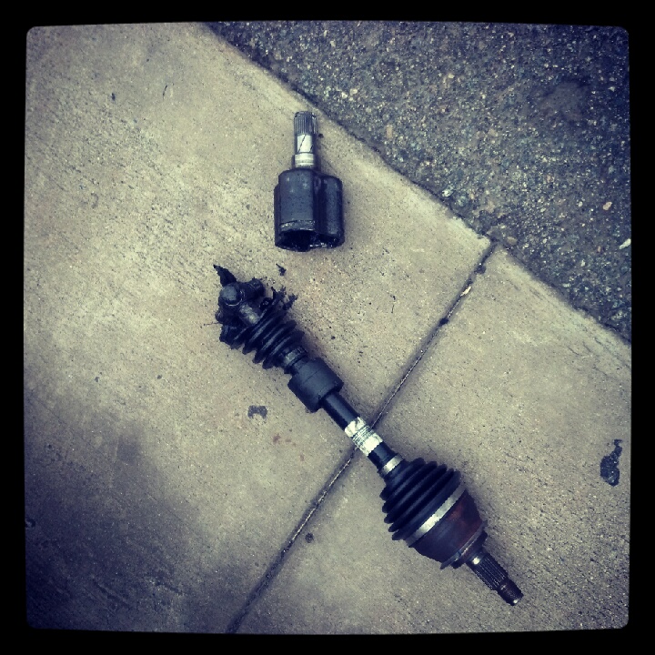

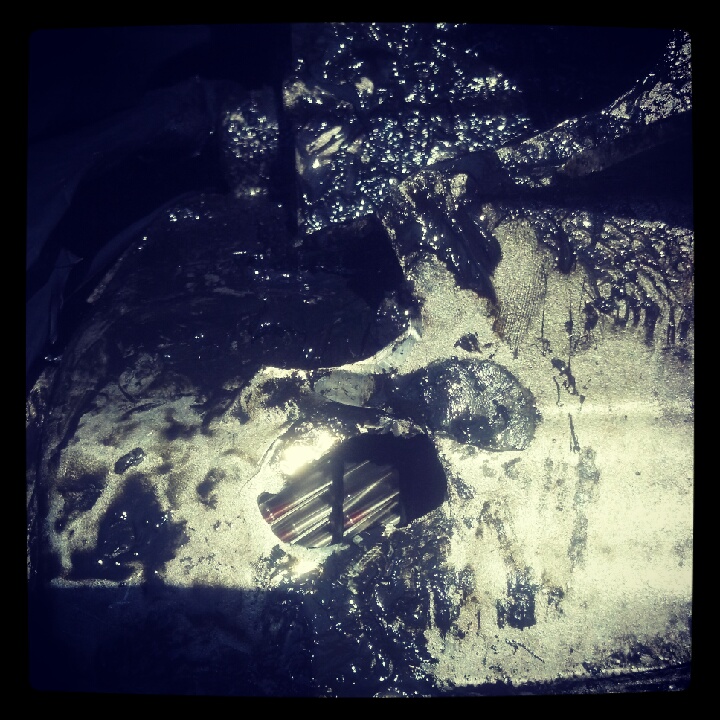

playing the r56 low game..

Jaremy.... You broke another axel????

I am currently having my 3rd transmission this year installed.
I am on my 19th axle.
EDIT:
Before everyone comes up with their idea of what is wrong. Dont as I have already figured it out.
Its called too low for an R56 to go on 17s.

Cause all i have done is throw axles at the problem.. lets be smart.
This year I have gone through, a frame alignment, new wheel/bearings, new ball joints, new control arms, new end links, new sway bars, etc. Hell Ive gone through 1 insurance claim, 2 MINI dealers, 4 shops and until recently still had the problem, which is now most likely resolved.
Its not like i have just thrown axles at the same problem. Granted some of the axles were warrantied. Plus I have gotten both my trans for extremely cheap from some people who know people hahaha.
I am saying that MINIs cant be lowered to a certain point, **** some axles last 10 ft, not much planning one can do there. Some even happened when I had my KWs at their highest setting.
take your stupid is as stupid does and shove it gladly where the sun doesnt shine.
thanks.

Originally Posted by Boosted_Mini
Now I know most people slam R53/6s on 16s not 17s which i think is why some people havent had problems, I am on 17s so I have to work harder and ride with my coilovers lower to acquire the same height of someone on 16s.
Just to be clear it doesn't matter if you run 16s or 17s. That won't have any effect on axles as far as lowering is concerned.
Its all about the position of the hub in relationship to the transmission. The only thing that controls that in this situation is what you have your coilovers set to. What were your V1s set at in the front when you blew all these axles?

I have ridden my mini at all sorts of heights.
I get the idea thats its hub relation, but I am saying is I was running my coilovers extremely low to look as low as cars on 16s when on 17s if that makes sense haha.
I think part of my recent issues spur from the KW V1s softness and height as well as TQ.
But when my car comes back on monday with the new os giken lsd and jcw trans paired with the new coilovers that are on it we shall see if the problem is fixed or not.
I dont think I have ever had shuddering, I have had popping and metallic noises in the cvs before thats about it.
