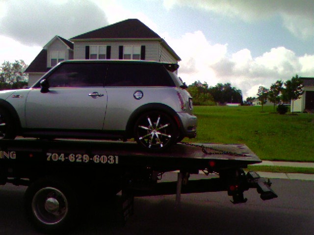

Old Sep 6, 2006 | 07:43 AM
Kendel72's Avatar
Kendel72
Joined: Oct 2004
Posts: 472
From: Dallas, NC

Old Sep 6, 2006 | 04:18 PM
Gromit801's Avatar
Gromit801
Posts: 11,600
From: West French Camp, CA
You probably didn't need to have your Mini towed to the dealer though. It would have been safe to drive it over, without the risk of the tow operator damaging your Mini.
Yeah I coule have driven it but its 45 minutes away, I work 3rd shift and I was tired!
