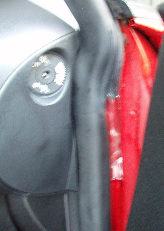

Rust in MINI cooper door sills SOLVET !!
Hi
I have read all the incoming remarks regarding rust in the door sills of older models MCS from 01-05.
My car is the new model 2007, but I wanted to solve the problem, before it rusts.
I live in Denmark, where we salt on the roads every winter and it rains a lot.
Therefor I checked it out on both sides af my car.
And No rust (its 16 months old) but it was very wet under the rubber list.
Therefore I tryed a number of things. While I washed the car or/and it rained!
In the end I tried to put an ordinary plastic chateque (see pictures) under the rubber list. I cut it so it was in a square. I put several pieces after each other(see picture) . It is almost not visible(clear plastic).
One picture is (as another stated)with plastic up under the A (pole)!! and here I also put a piece of plastic chateque + I put some silicon in there, where the list is open. Yes for some reason the rubber list is open in the middle?? I dont know why!.
BUT THIS WORKS - I have not any moist or water or humit under the plastic(direct on the metal door sills) anymore!!!

Thanks for letting us know that the design flaw has not been addressed with the redesigned MINI's. Your pictures aren't the sharpest, but if your plastic is sealing the space between the sill and the rubber gasket, any moisture that finds it's way in there will be very slow to evaporate, if ever.
