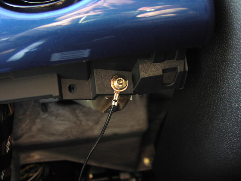

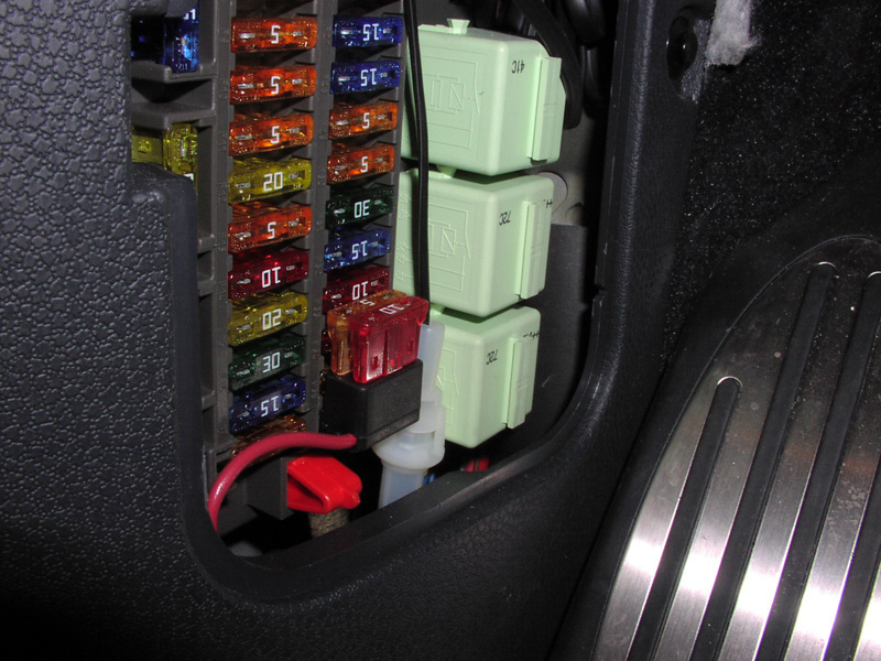

You made that 10x more complicated than it needed to be. You have shorted your radio, and blew it's power detection. It thinks the car is off all the time, that's why you have to turn it on, and why it goes off every 30 minutes after you do so.
All you needed to do was wire into switched power and ground like shown below:
Wire it correctly, lose the hokey switch, then check and replace the radio fuse you blew.
Attached Thumbnails Heres a weird first for me, problem wise? let see who can get this one-picture-225.jpg   Heres a weird first for me, problem wise? let see who can get this one-picture-226.jpg
