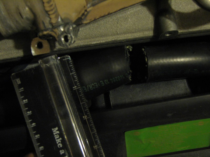

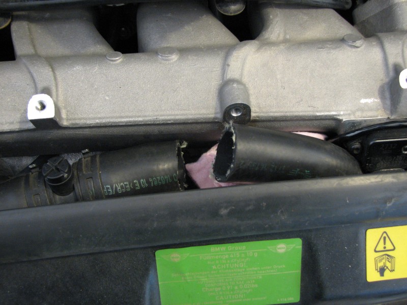

Old Oct 17, 2005 | 07:26 AM
betet's Avatar
betet
Joined: Apr 2005
Posts: 322
From: Santa Clara, CA
Norm,
where did you get this measurement from? I guess it would depend on where you are cutting the radiator hose... So from my measurement, it's either a 1 inch ID or 1 and 1/16" ID.... I had a 1 3/16" brass pipe that I was trying to force between my hoses, but no luck.. It just wouldn't fit...
///Gilbert
Attached Thumbnails Radiator hose size?-hose_001.jpg   Radiator hose size?-hose_002.jpg

betet, on closer inspecton I see the hose has a formed bell where the Breather Tube coupling fits in the hose. With your ruler what size is the ID of the hose in that section?
Old Oct 17, 2005 | 11:07 AM
betet's Avatar
betet
Joined: Apr 2005
Posts: 322
I may be wrong here, but I think from the manufacturer the hose ends were made to be wider than the real ID of the hose to make sure it fits the breather hose (which is thicker than the hose's ID)...
When I was looking for my pipe to tap in the middle, the breather hose is what I also measured using the circumference to try and get the diameter.. But as I found out the hard way, my measurements didn't agree w/ the hose and my brass pipe... I'm going w/ a smaller 1 inch pipe...
I'll try to measure it at home tonight, to see if I can do a "guesstimate" with the ruler..
///Gilbert

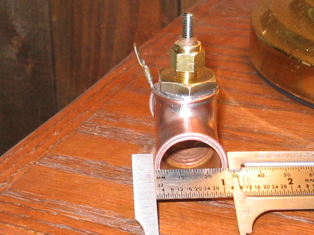

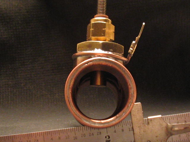

Hi Norm:
If you are going with plan B, here's a link given by MINI146 that can be used.. Make sure it does fit your sensor.. Anyways, look at the attached pictures for the measurements.. I think you would want whatever coupler you would be using to be about 1 inch...
I am using this coupler I had when I was running a TEC 3 unit in my Miata... I'm not sure if it came w/ my TEC 3 or someone just gave it to me..
///Gilbert

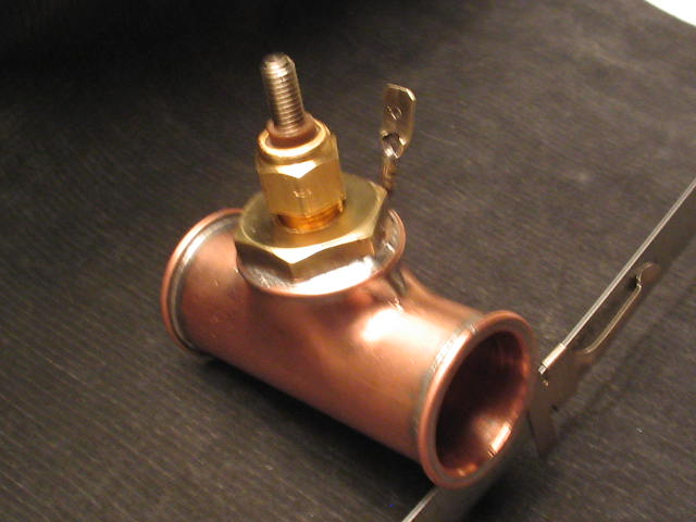

Earlier post in my quest to add a water temp. gauge;
https://www.northamericanmotoring.co...ad.php?t=52052
Here is the part I made to insert into the radiator hose as betet did.
Thanks to betet for leading the way and providing measurements.
I wish there was a place on this forum to store this stuff for the next member looking to do this Mod to their MINI.
Attached Thumbnails Radiator hose size?-100_0006.jpg   Radiator hose size?-100_0005.jpg   Radiator hose size?-100_0007.jpg
