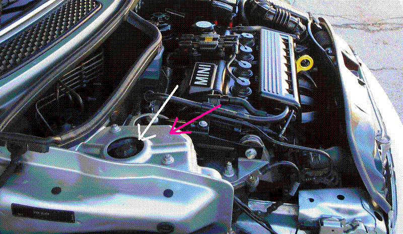

In the attached picture (pic stolen from another thread...my camera is broke, or I would have taken my own pics), you can see the white arrow pointing into the area where you will need to look. There's a cap there, but you don't need to remove it to see. Just check around the area. The other arrow points to the area that the dealership will check for "mushrooming" to determine if you've hit the suspension hard or not.

It sounds like responses in the other thread seem to indication this happens with normal driving. So is this a real big safety issue?
