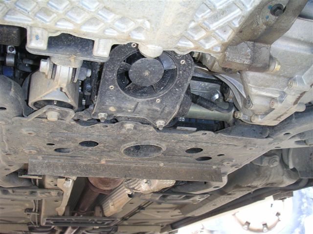

I've read a few alarmist threads about the achilles' heel properties of the MINI's power steering fan. Apparently its position is such that flying road debris can find its way over to it and jam it. I also read that the 2005 MCS has a plastic shield over it that either helps or does very little to help this situation. I found a few aftermarket stainless steel fan shields that were reasonably priced so I was thinking about acquiring one. But first I thought I'd check out the situation on my own 2005 MCS (convertible). After popping the "bonnet" I looked near, beside and even behind the radiator for this "weak link". I couldn't find anything even resembling a fan beyond some heiroglyphics that suggested that there was a fan deep inside the radiator and for that reason I shouldn't store any of my ties there.
I was, however, looking from the top of the engine and not from beneath. So the dumb question is this: Where the heck is the power steering fan? Thanks for your help.

Jack up the front, look under

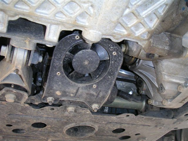

Thought I'd post a picture for those that haven't seen the PS fan. Mine is a March 03 build MCS and they had already split the PS and radiator fan circuits so it must have been done quite early in 03 :smile: .
It does seem like quite an odd design as most cars with electro hydraulic power steering that I've seen get away without having a cooling fan
