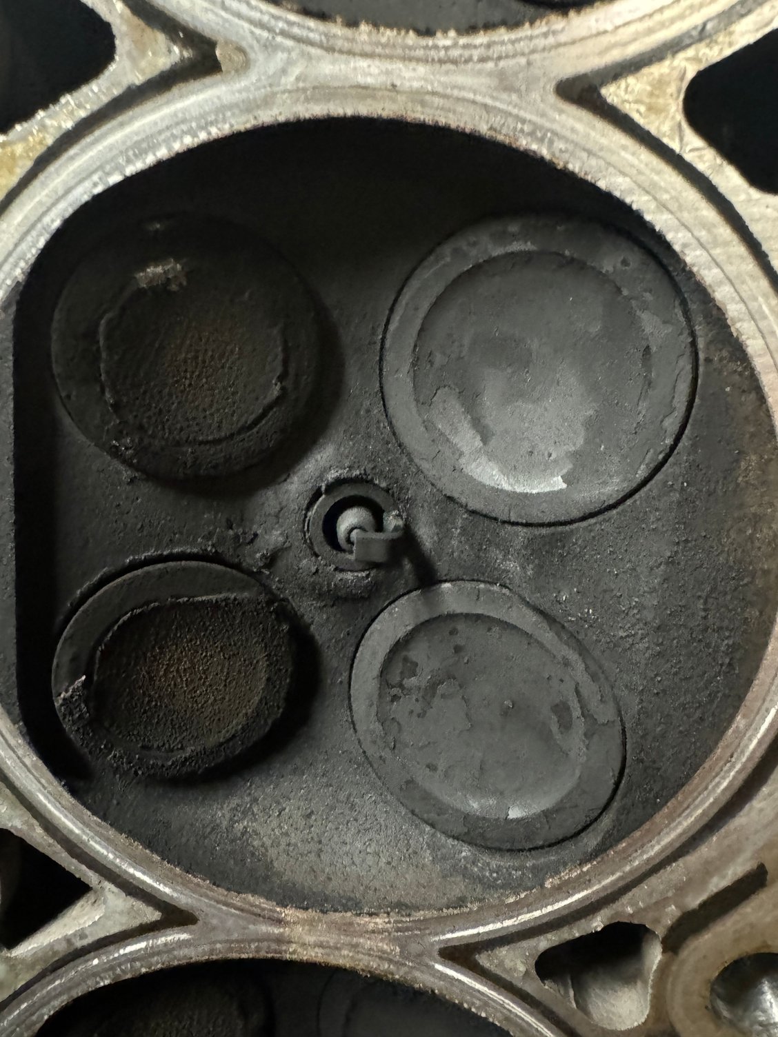

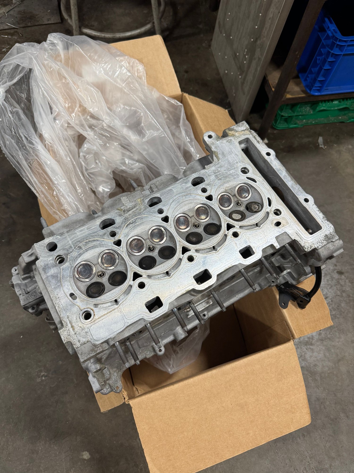

Old Oct 31, 2025 | 02:33 PM
Rh1988's Avatar
Rh1988
Joined: May 2025
Posts: 21
Heres a pic of the head when i had it off
After hot tank
Old Oct 31, 2025 | 02:39 PM
Maybe, maybe not's Avatar
Maybe, maybe not
Community Builder
Community Influencer
Joined: Jul 2023
Posts: 1,577
Likes: 215
Originally Posted by Rh1988
so that being said you still recommend getting new??
If I thought that the plugs and coils were cheap aftermarket parts, I would replace them in a NY minute.
And the refurbished head looks great. I'm looking forward to you solving the misfire issue, and the smooth running engine puts a smile on your face.

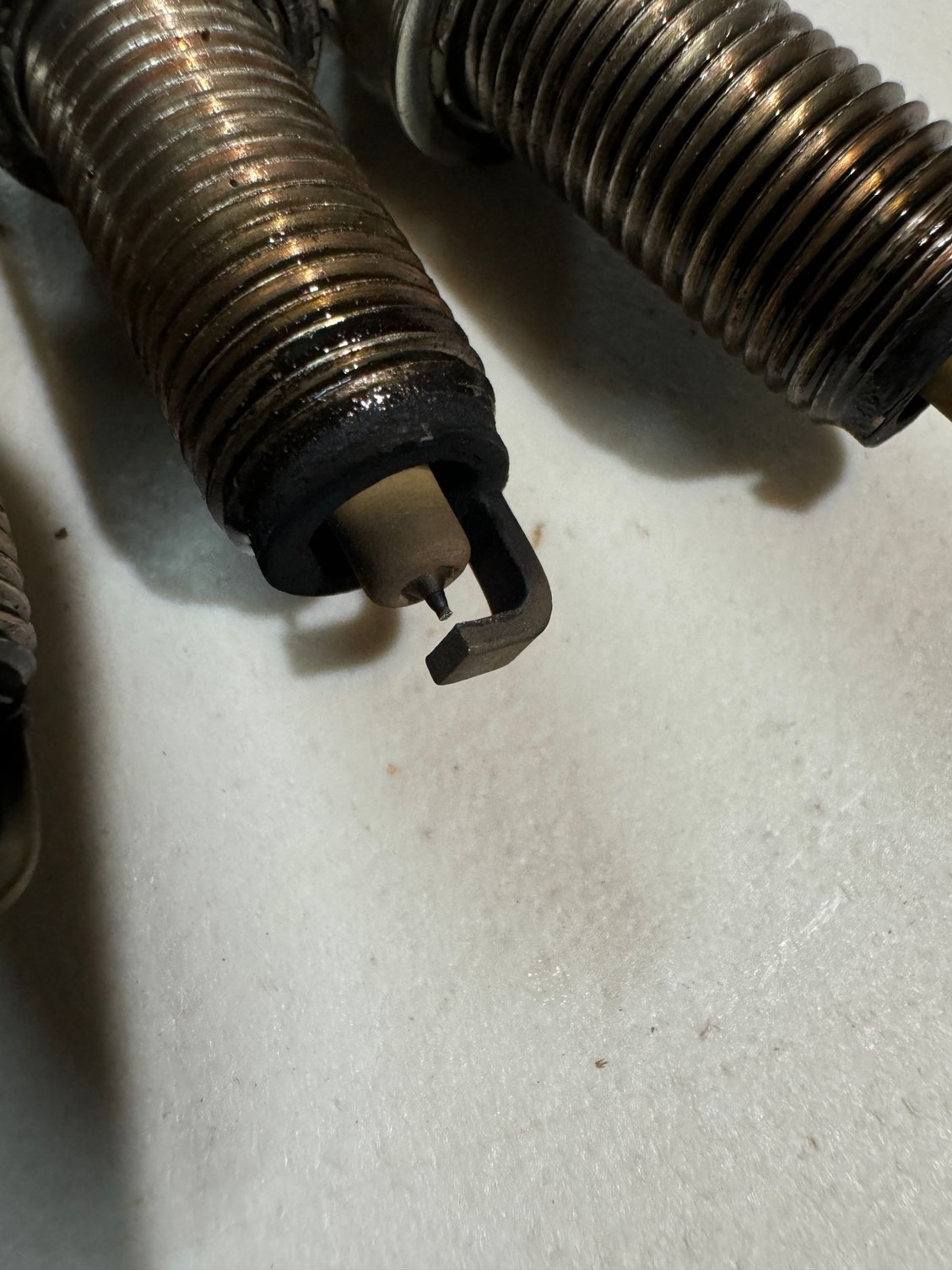

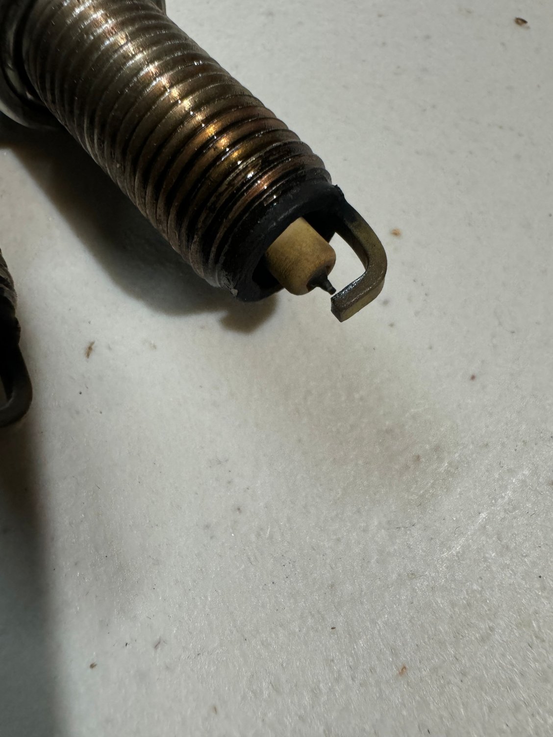

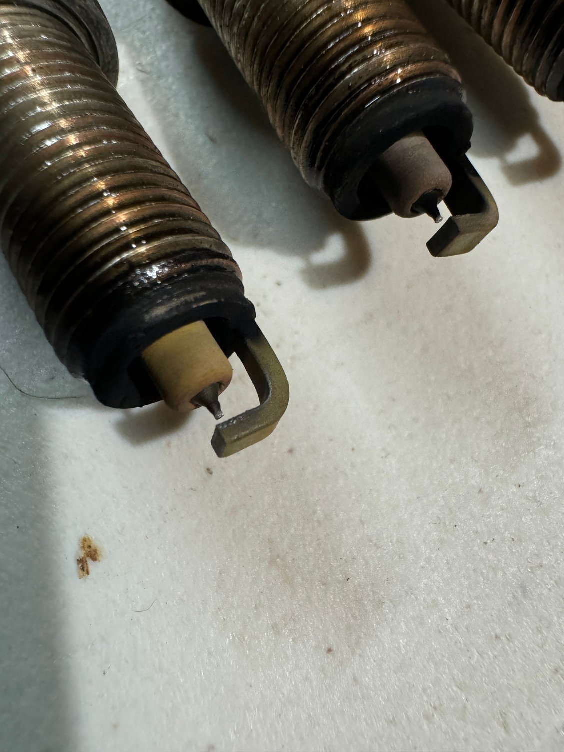

Cyl1
Cyl1
Cyl2
Cyl2
Cly3
Cly3
Cyl4
Cyl4
replaced them with lazer iridium ngk and also put the old coil packs on instead of the cheap aftermarket ones so far the light is off and haven’t counted any misfires but need to take it for a drive

The black soot on all 4 spark plugs suggests a rich condition or that all four cylinders are experiencing misfires. Curious.
Cyl1
Cyl1
Old Nov 8, 2025 | 07:56 AM

Did spark plug 1 look more sooty or different in any way from the other 3 plugs?
Old Nov 8, 2025 | 08:25 AM
Rh1988's Avatar
Rh1988
Joined: May 2025
Posts: 21
they all look pretty similar to me but
left to right 1-4
maybe 4 looks a lil more sooty
