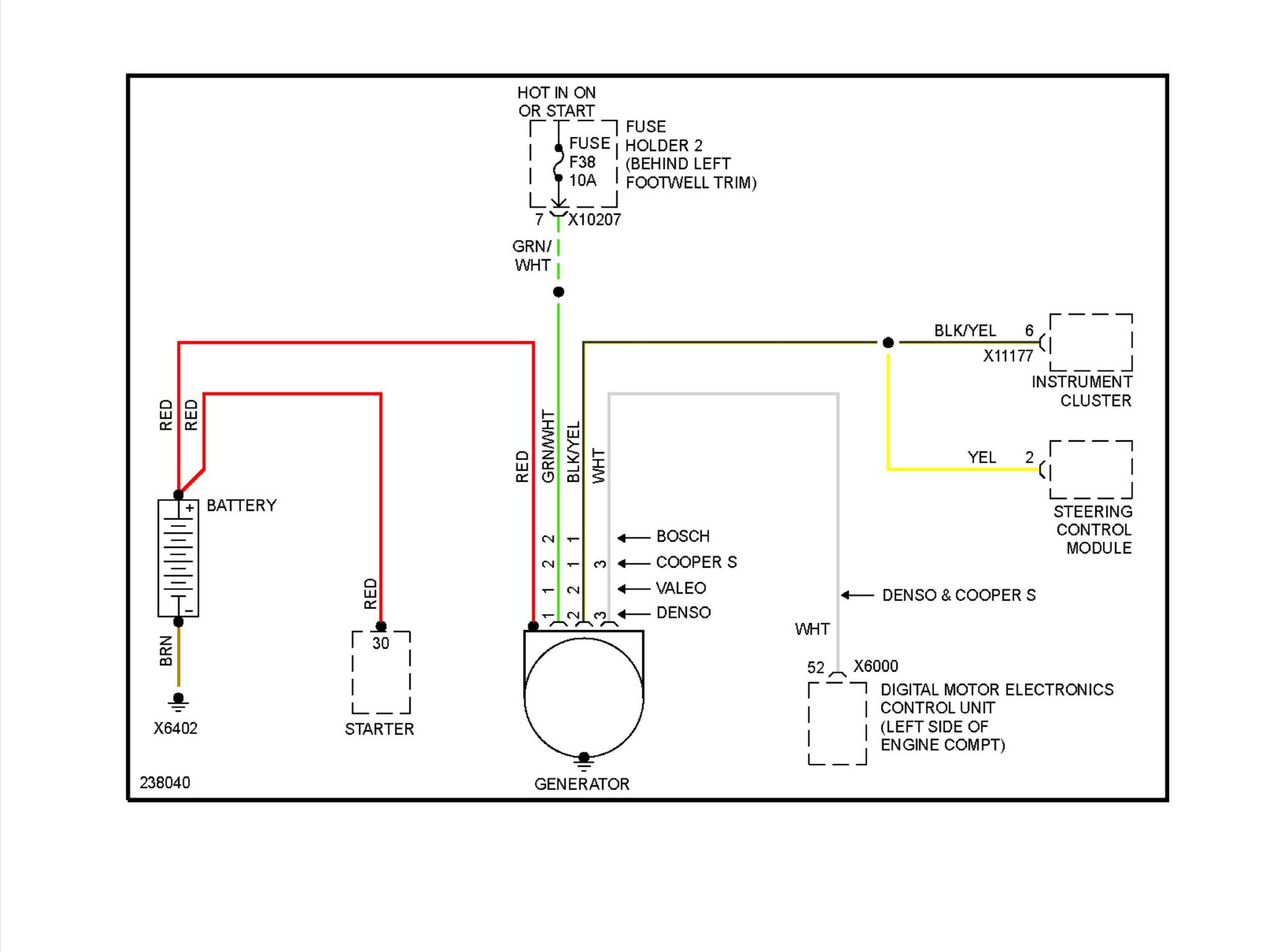

This may help.

I appreciate the diagram. Unfortunately, in my 2004 R50, F38 in the driver-side footwell is left blank, both physically and in the fuse diagram on the back of the panel.

It looks like that may be a typo, and it should be F39.

I checked that when I was in there. That fuse is good. Is it plausible that my son, when installing the starter put the alternator cable on the wrong post of the starter? The two large terminals, we'll call A and B. I think he has the alternator connected to B, and the Battery cable to A. Is this correct? The car starts and runs, just doesn't charge, so I know that the battery being connected to terminal A is correct.

That doesn’t sound right. Isn’t one terminal on the starter the wire from the DME?

CAR IS FIXED. Thanks to the wiring diagram, my hunch was correct. Moved the alternator cable to the post for the battery cable. All problems are resolved. You guys are a treasure trove of knowledge. Now on to the next problem!
