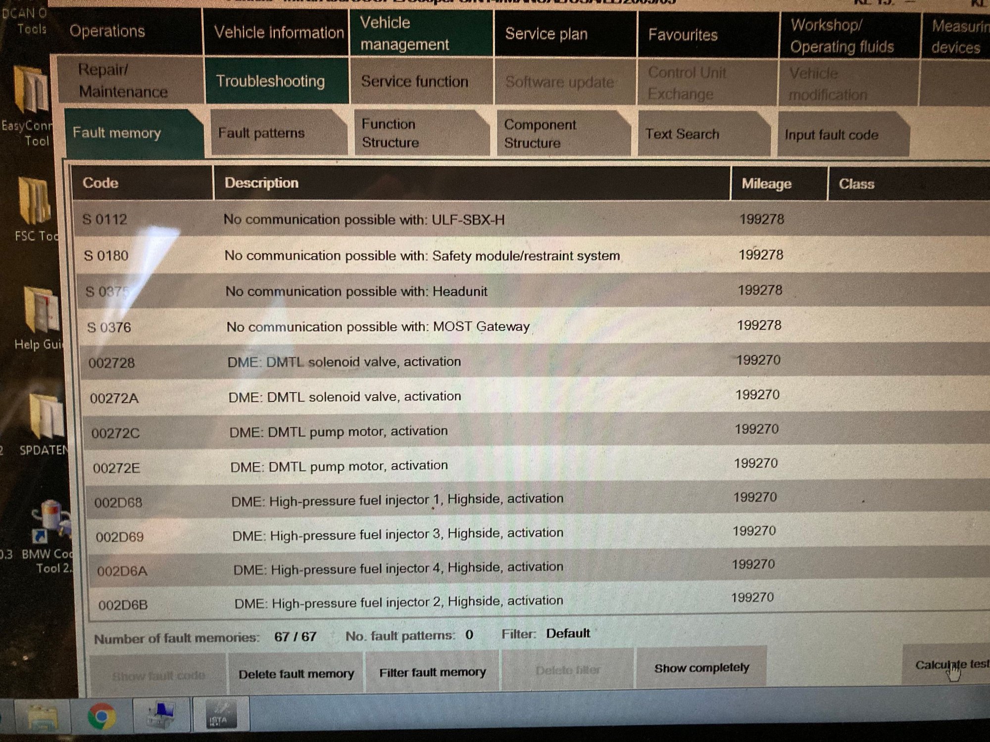

I replaced the battery. And these are the new codes that popped up. So now from the looks of it I need to replace my ECU?

it is hard to say without reading the actual fault codes.
reprogramming it might help update the software but does not guarantee it working IF there is an internal fault.
Try swapping the relays next to the ECU Specially the small black one with one of from the top row (top row is for the wipers and the bottom one is for the ECU)

Originally Posted by Masonotfound
To elaborate, there’s an aftermarket head unit. On a second look, I’m not sure what’s up with the most gateway. I’m not sure if I’m still getting that code. Do you know what that is?

I think the gateway is for the radio head unit which also connects to the bluetooth module. you have 67 fault codes though! I would clear them and rescan the car to see what pops up again. These could be a result of the short caused earlier.
Ok, I’ll try that. Is it possible that, if there aren’t any applicable codes, this could be a jbe issue? Thank you very much for responding by the way. It’s a relief to have some help. I’ve already tried switching those relays btw, I forgot to mention
