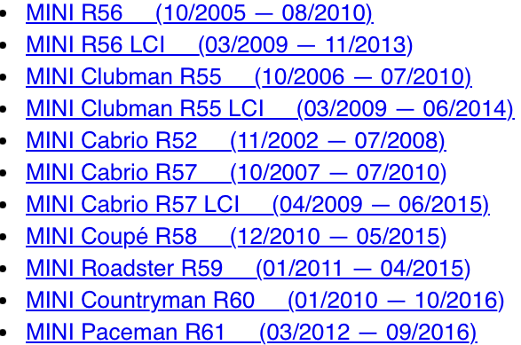

BMW/Mini Cooper knows full well and have a solution for resolving and have no idea why they/vendors continue to sell boot/trunk/hatch “Contact Switch”/61319119052 (realoem.com) when owners should order the longer “Contact Switch”/61319119057 with the extended probe that keeps boot/trunk/hatch llight off and your battery from draining due to the incorrect sensor. “Contact Switch/61319119057” fits the following Mini Cooper models based upon original (realoem.com):
