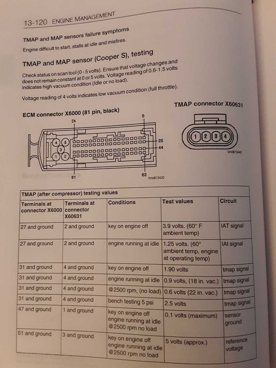

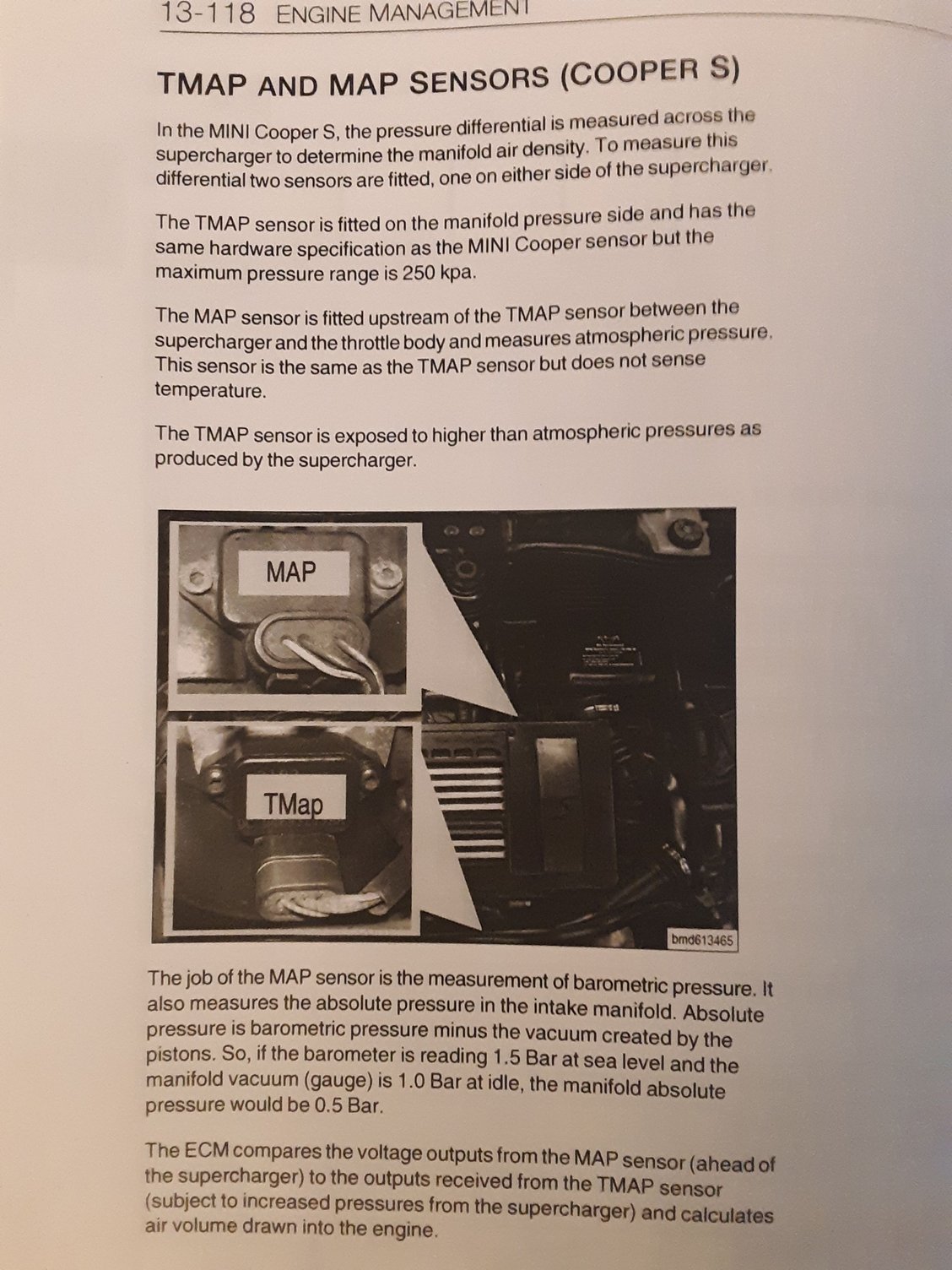

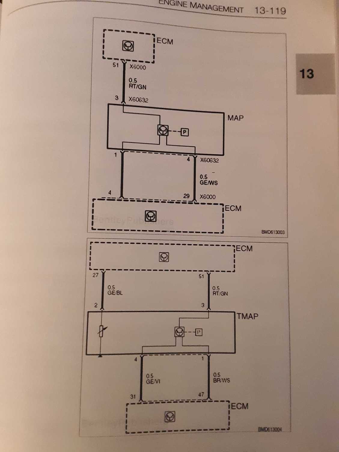

i have a longer than usual cranking to fire it up also runs a bit rough at idle and misfires slightly.
Sounds like it, or its TMAP twin. In case it helps, from Bentley's MINI Cooper / Cooper S 2002-06 Diagnosis without Guesswork:
TMAP and MAP Sensors (Cooper S) p. 13-118
TMAP and MAP Sensors (Cooper S) p. 13-119
TMAP and MAP Sensors (Cooper S) p. 13-120
TMAP and MAP Sensors (Cooper S) p. 13-121
