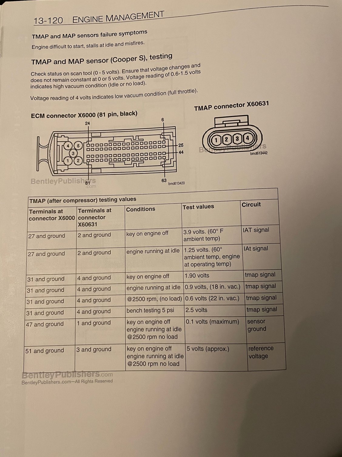

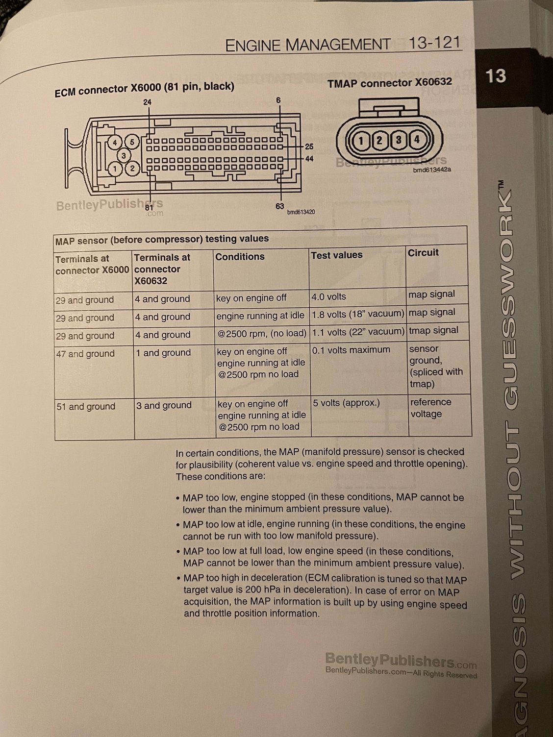

Is there somewhere I can find what the MAP and TMAP sensors are supposed to read? Knowing what to look at is one thing, understanding what you're seeing when looking at it is the key.

Also avail in Bentley (the tmap and map readings)

Old Feb 1, 2022 | 06:20 PM
ssoliman's Avatar
ssoliman
Joined: Feb 2018
Posts: 1,736
Likes: 330
Old Feb 1, 2022 | 06:22 PM
ssoliman's Avatar
ssoliman
Joined: Feb 2018
Posts: 1,736
Likes: 330

Originally Posted by ssoliman
Thank you!
Now I just need to fix the cracked radiator so I can drive Grumpy and check this data.
