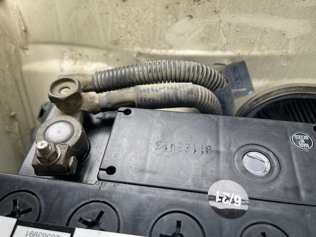

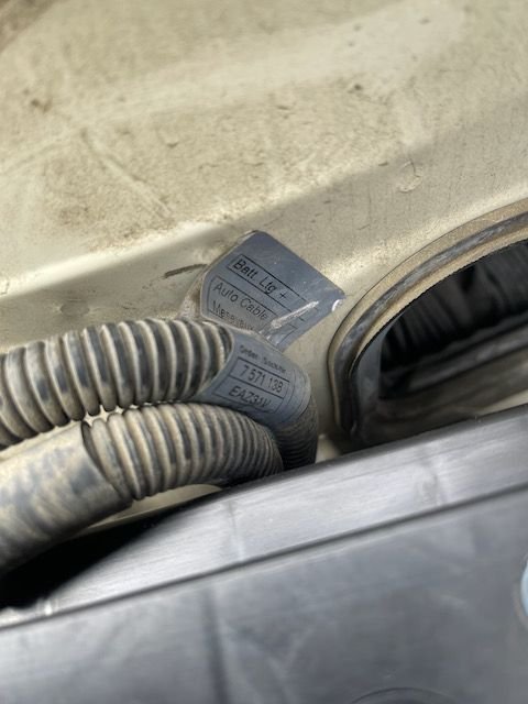

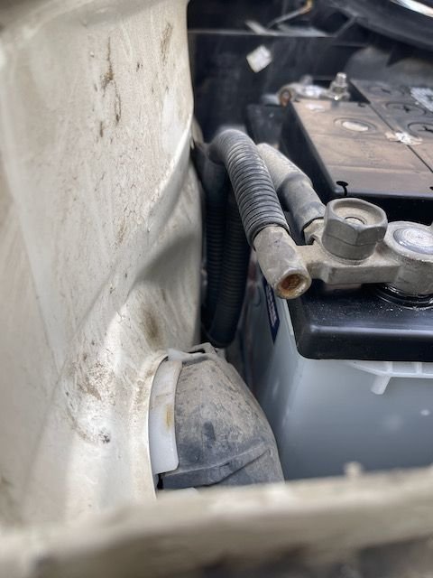

Can somebody tell me from the photos if my car has IBS or not, and so does it require "registration"? I don't recall that previous technician who replaced did this.

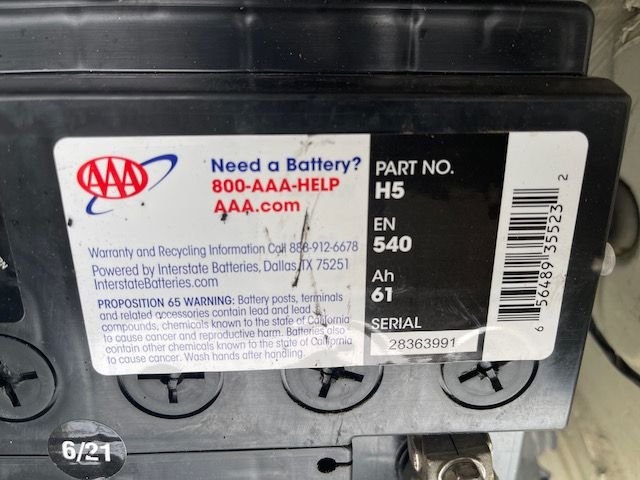

I will also upload photo of battery details for review.

The IBS is on the negative terminal and it looks like a fuse. My 09 doesn’t have it so you most likely don’t. I used a platinum battery from O’Reilly’s which is their agm. Have no issues, didn’t have to register it, just had to reset the clock. I have bimmercode, registered it and nothing changed.

Thanks so much - very helpful to know that the IBS is on the negative terminal. So, I don't have it.

If your car has no IBS, I would deem it unlikely that it was fitted with an AGM battery from factory. And if the previous battery was a standard type battery, I would think it even more unlikely that AAA replaced it with an AGM type (which are quite more expensive).
Also, an AGM battery would not have a visual inspection window for fluid, let alone service plugs for the latter. The picture you posted definitively does NOT show an AGM type battery.

They state that they have no current fitment for my 2008 Mini Cooper Clubman S, and "should not have installed a replacement battery on June 30, 2021".
They were unable to check if they "had a current fitment" in 2019 when I purchased the original battery.
Amazingly, they were also unable to tell me what kind of battery (SLA, AGM, etc.) they actually installed, since they installed a battery of which they deny the existence.

I wound up replacing with an O'Reilly lead-acid battery, not AGM. My car does not have the sensor and did not come with AGM battery. I think only 2008 models with Nav system came with AGM.
Replacing the battery myself was a snap, and I upsized to the proper H6 size. Though I have to re-install battery, I did not realize about the back lip, just just have to go back and re-seat it yet.
Very disappointed in AAA battery service, they put in an H5 in 2019 for what reason I do not know. I have read that H6 is a "difficult fit" but my car came with an H6, and I had no difficulty installing it. AAA contractor had also not bothered to connect the vent tube. This battery is under the hood, not inside the vehicle, but nevertheless there is a vent tube and it must be there for a reason. (Of course, I hooked up the vent tube. It was there, just not connected to battery.)
Need to take the old (AAA-Interstate) battery back to get back core fee. The old battery 3 months old (AAA replacement) only charges to 60% and rapidly drops to 30%. (per charger, at least). It is lead-acid, NOT AGM as AAA contractor told me. He told me I "ruined the AGM battery"
