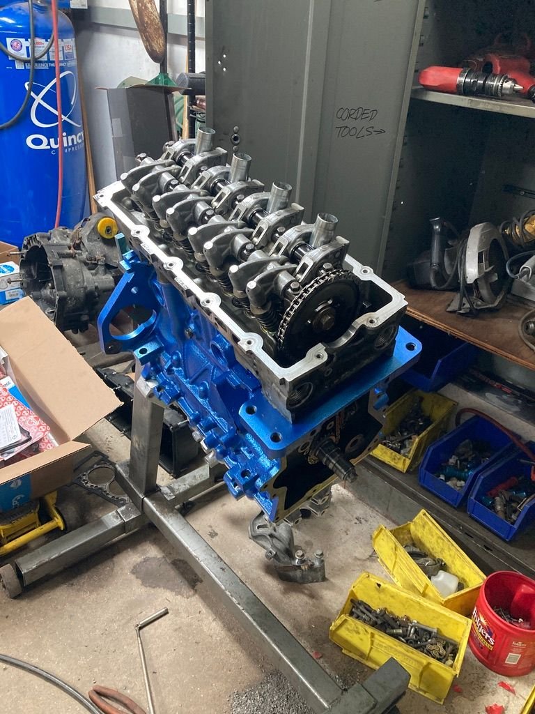

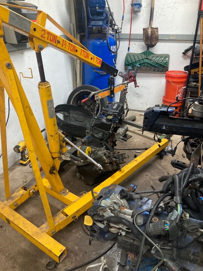

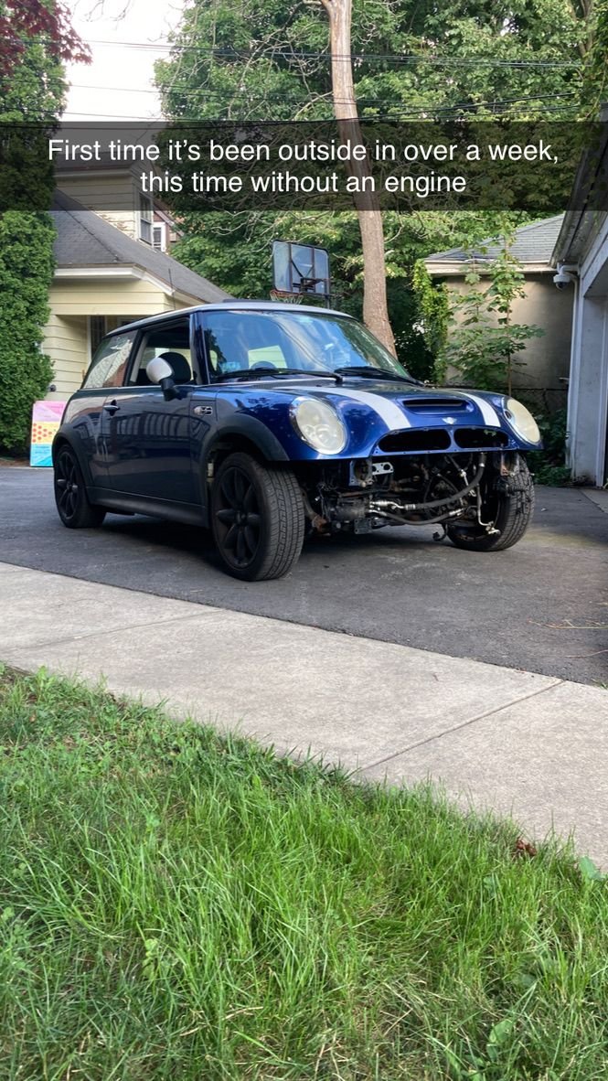

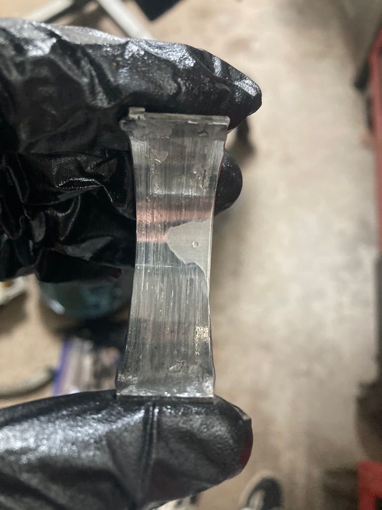

Here's some pictures from the engine swap:
This was the first day I started working on the car, prepping it for the engine to come out
This was the next day

The damage speaks for itself...

This was three days ago
This is the stage the car is at currently. Just trying to get the motor sorted ASAP because I'm so ready to drive it!
