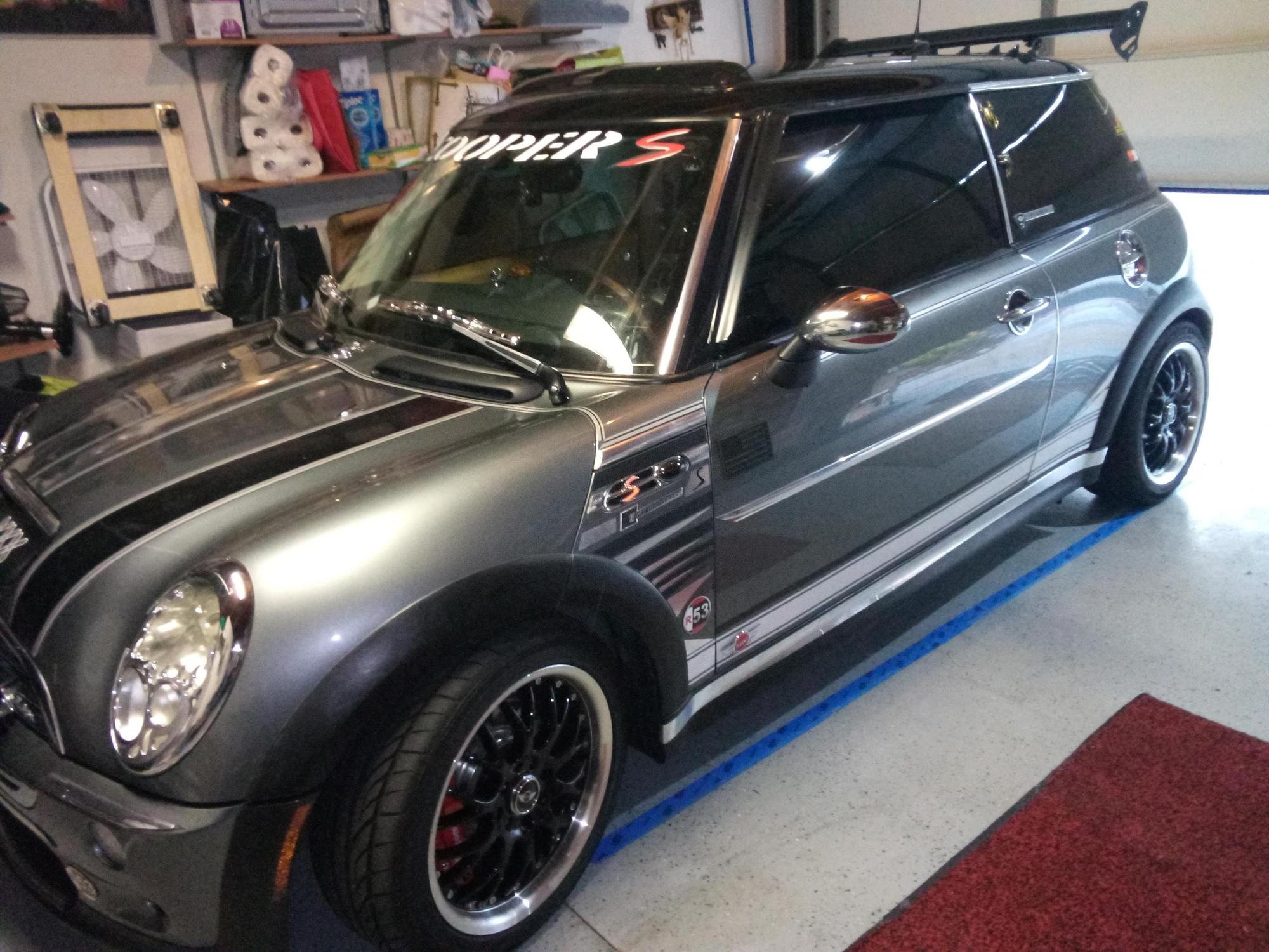

16" drag wheels with Manzo lowering springs, adjustable Godspeed end links and Forceum Hena tires 205/45/r16
