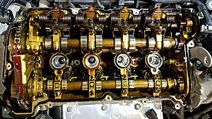

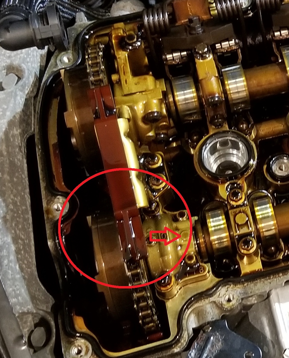

So i did the valve cover and did the upper timing chain guide since the plastic was shifting a bit and bent a little higher over the age! the new guide sat perfectly and pressed chain down a little more.
Upper Chain Guide shifted/raised a bit.
