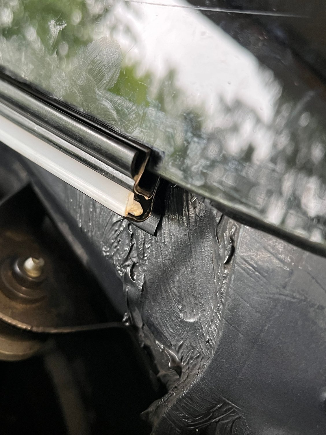

Old Jun 15, 2025 | 01:57 PM
BEPR56's Avatar
BEPR56
Joined: Sep 2016
Posts: 13
Any help is appreciated
The photo for orientation was extremely helpful, but I cannot for the life of me get the channel onto the windshield. Part of me thinks the extra material where it sits against the forewall is in the way. Should that extra flap also be going up under the windshield or do I need to pull it down?
Old Jun 15, 2025 | 11:50 PM
Velcross's Avatar
Velcross
Joined: Jan 2025
Posts: 95
Likes: 57
From: Canada
I just did same on my car 2 months ago
it was a struggle but you have it in the correct orientation. I had to ensure the “extrusion flap” to firewall side was folded under correctly. That can keep the channel from seating correctly. Mine did fold out “out” it went under windscreen
At least that was what I experienced
Don’t remove the white plastic strip until you’ve installed the channel

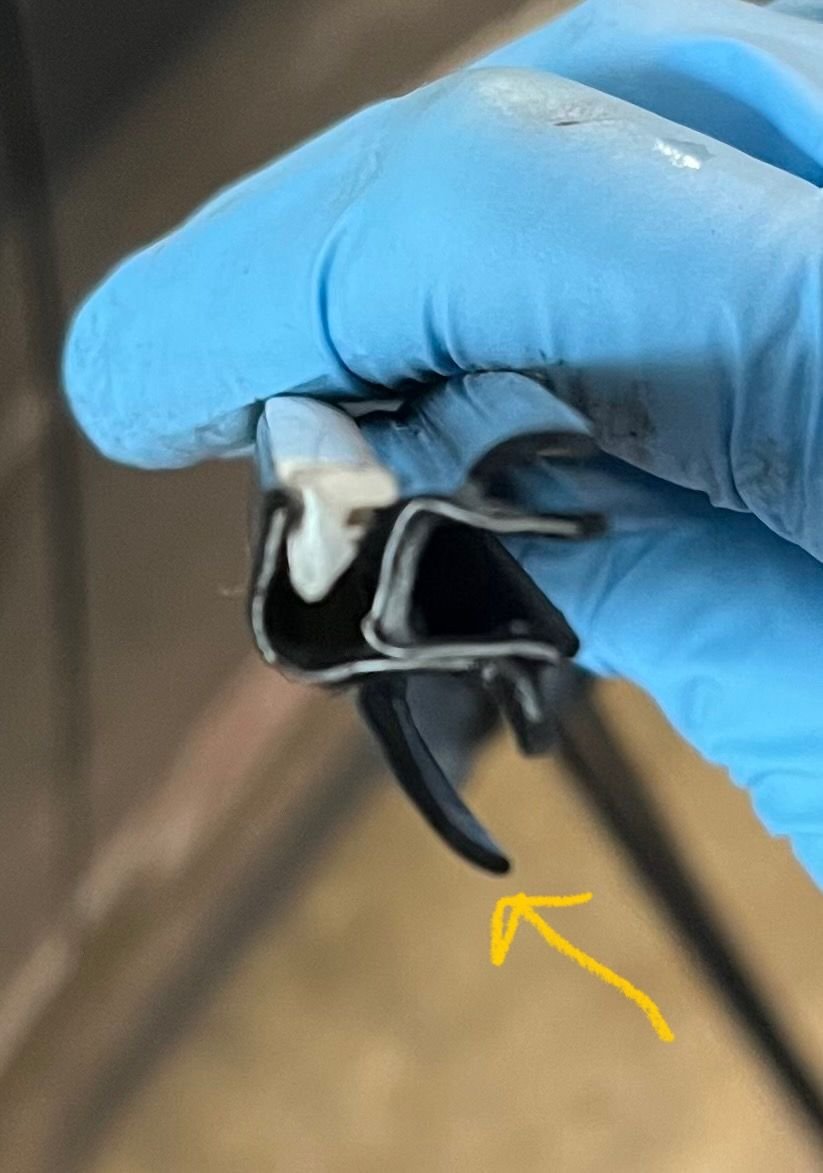

Old Jun 20, 2025 | 06:55 AM
Posts: 36,759
Likes: 2,548
Sorry i just saw this, yep when the front window gets replaced...(99% of MINIs have the front window replaced due to how low and upright the window is). The company that does it (safelite, etc..) adds too much window weld and on the bottom the gasket does not have enough room to hook on. Ask me how i know with multiple MINIs and windows replaced. You have to trim back the under side window weld a little. Hopefully when you do that they did not get air bubbles or a small bead as that would then let moisture in. Rare but i guess it could happen.
That's the way you have it above, you just remove that white "holding strip", push the seal upward on the glass so its flush after you trim back some of the betalink/window weld.
Then the cowls go in that slot tab where you removed the white holding strip.
That yellow arrow lip should push up and on the body of the car to seal. This prevents water intrusion.
