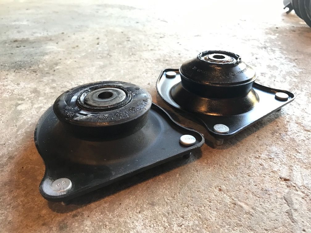

Old Apr 3, 2021 | 02:28 PM
rob_e's Avatar
rob_e
Joined: Jun 2008
Posts: 36
Likes: 11
One of my Lemfoerders after six months of mostly sitting in the garage, along the new Genuine MINI one that replaced it
