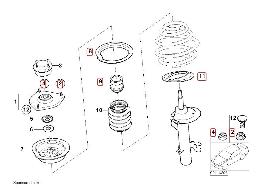

This happened to me too when I changed my struts for some Bilstein B6 --- it creaked like an old wooden ship on low speed turns.
I had noticed that my upper spring pads were quite worn, even slightly frayed on the edges, but I went ahead an re-used them because I had neglected to foresee the need to replenish them so didn't order. I was pressed for time and decided not to wait --- it was a mistake because I had to go back and do the job again just to add those dumb little pads.

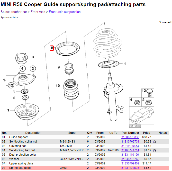

#8 on this chart:
Note that the part is 3mm which is BMW's "sport" version which all the R50/R52/R53 series use I think?
Pretty thin really, and likely with high mileage age & wear gets compressed even thinner I'd imagine.
BMW has a "regular" version that is quite a bit thicker at 10mm (part# 31331135589) but use of it on a MINI would raise ride height by 7mm.
