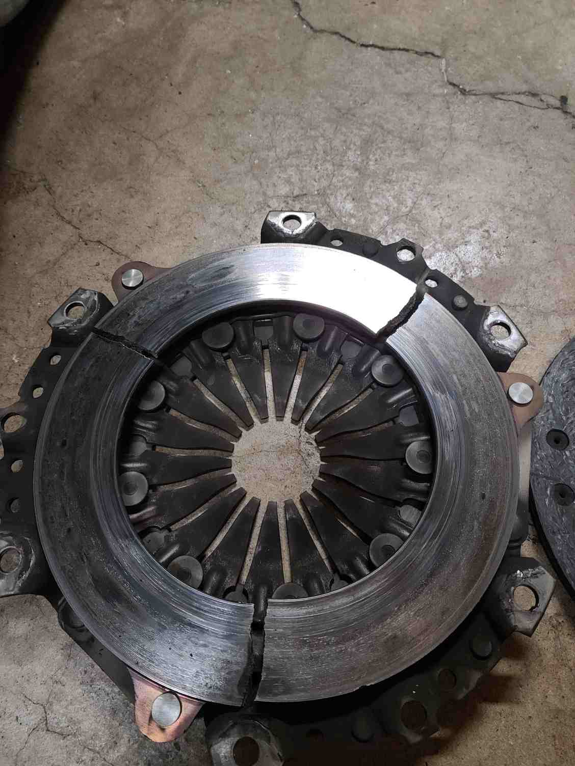

Busy day! After christmas and new years I decided to start working on the Mini.
Today i removed the transmission and clutch to get to the problem. With this job, you get to remove the subframe, the radiator, bumper, control arms, and all sorts of fun brackets and heat shields!
I will definitely be taking recommendations on what to replace on the subframe/suspension while its out, and also what other maintenance items are best to get out of the way...such as steering bushings or seals. I think I have a leak somewhere in the steering system that needs fixing.
Overall it took me about 6 hours to remove everything. With patience and a few select words, I finally got the transmission and clutch out. Everything was fairly easy until the top bell housing bolts came around. I broke the octopus wiring harness clip that holds it to the bell housing (which I really dont care much about because it is TERRIBLY PLACED). I also found a few random fasteners needing replacement. I have a list of about 20 things I noted while working on everything that I can revisit once I start buying parts.
The culprit of the clutch issue is shown below. The pressure plate has seen better days, and the slave cylinder was leaky at the plunger.
