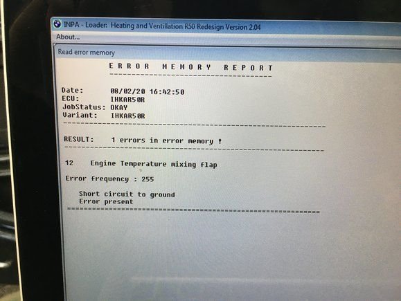

My 2006 r53 has no heat. I think it’s the actuator to the blend door / flap. Says it has a short to ground iirc.

inpa gives a code and calls it the “engine temperature mixing flap” I think.
on the ac control unit I have “FF” “01”. Forgetting what that is now. Need to look it up again.
as far as I can tell the actuator is under the dash on the right side. Might be able to access by removing the glove box, might have to take out the dash, I don’t know yet. Really hope it’s the first
