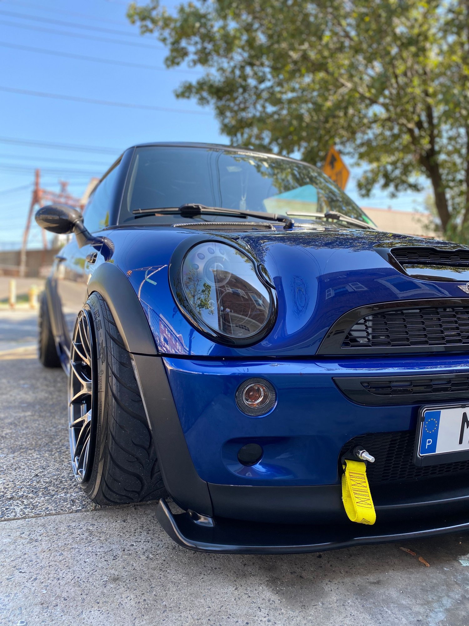

Ok so heres the issue. First all check out my car on Instagram @__miniac__ so you can see my setup. I have coilovers with dampering and camber. 17x9.75 wheel in the front with 215/40/17 tires. Was driving to a show on the highway keeping up with traffic at 80-90MPH for an hour straight and no issues then all of a sudden i feel the steering wheel vibrating, i pull to the shoulder, checked it and nothing seemed loose. So decided to keep driving, get up to 75mph its driving just fine and half a mile down the road it starts to vibrate again. Pull over once again, checked the car nothing is loose, tires were good. This time i decided to just go back home so i Took off again this time I decide to keep it at 65mph and drove back home an hour away and not one vibration. I am so confused. Anyone know what it might be?

nice setup btw. Those tires look so wide on the front, even though they are only 215s
