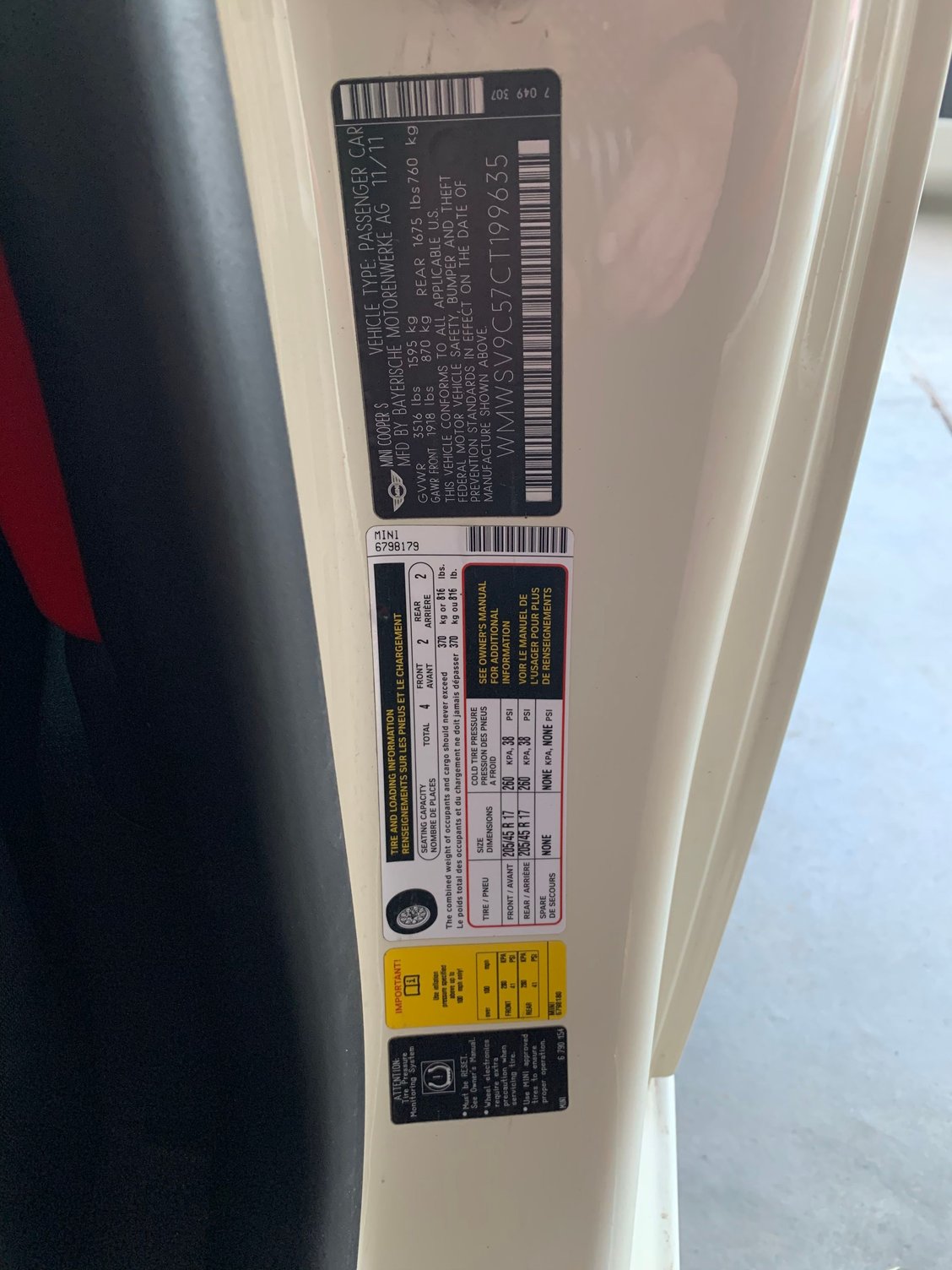

Thanks for the reply’s. I’m getting pretty confused trying to order the correct thermostat housing though. I’ve got a few choices. Mahle, Gates, Rein, Facet, Beck, Four Seasons, Stant and Motorad. Per zrickety input I’m eliminating the Rein. My problem is I don’t know my engine code. It looks like the engine could either be a N14B16C or a N18B16A? Some brands don’t have different housings for different codes though? Some have different housings depending on the build date? Could someone help me figure out what housing I should be ordering? It’s a 2012 JCW hatchback. Here’s the VIN plate and I’m assuming the car was built November of 11?
Also, what brand of housing do you guys recommend?

Take your VIN, go to realoem, and put it in there. Then click yourself through until you reach the thermostat. Look at the image, compare to what you see in your engine bay, them copy and paste the part number into ECS or rmeuropean or your favorite dealer. I think rmeuropean has a label what is OEM equivalent. Don't pay for the genuine. And don't forget to also buy a new pipe.

You have an N14 JCW engine. 11/2011 production.
https://www.ecstuning.com/Mini-2012-...ng/Thermostat/
If the thermostat has never been changed then you will need the pigtail https://www.ecstuning.com/Search/Sit...h/12517646145/
