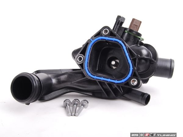

Its at the beginning of the thermostat housing leak, mine was on / off.... then boom, finally leaked all they way. Check the thermostat housing , then the water pump area. My water pump then leaked a couple days later, so i did it wall at once.

I had the same experience....changed the thermostat housing and the leaks stopped.

Yep, I also had the aux pump running all the time issues followed by no heat from the interior heater unless reeving the engine. All clues of the thermostat.

Replaced the thermostat yesterday. After driving less than 50 miles I checked the level in the reservoir tank and it was at the minimum coolant level. Is that normal or do I still have an issue? I topped it off to the max level.

I just did the thermostat a week ago something after typing it off no more issues. Happy motoring.
