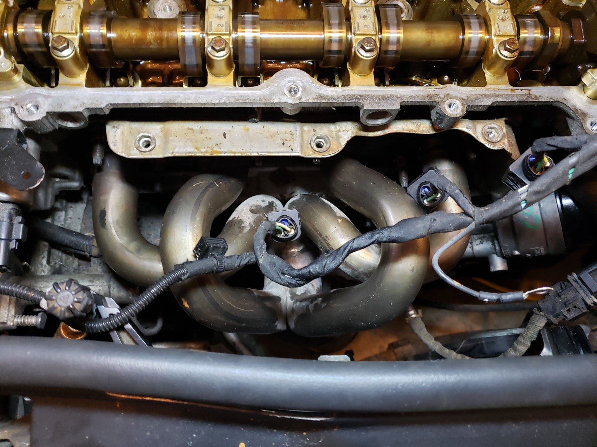

Could you provide pictures of the following:
cylinder head without the valve cover and from the front looking at the exhaust and the back looking at the intake.
ECU
cooling fan plug
other loose parts line intake and exhaust manifolds...etc

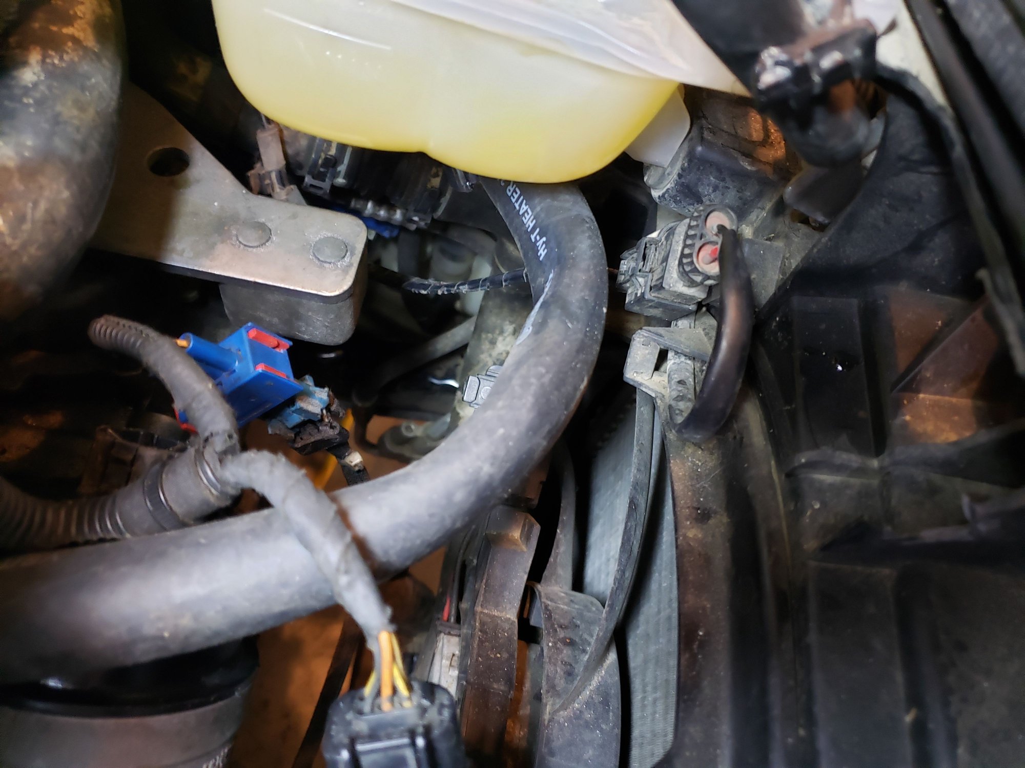

Now that ive taken the valve cover off, should i be putting silicone on the corners that had it before? I remember reading about people doing that after replacing the gasket.
Is this the cooling fan plug you were referring to?

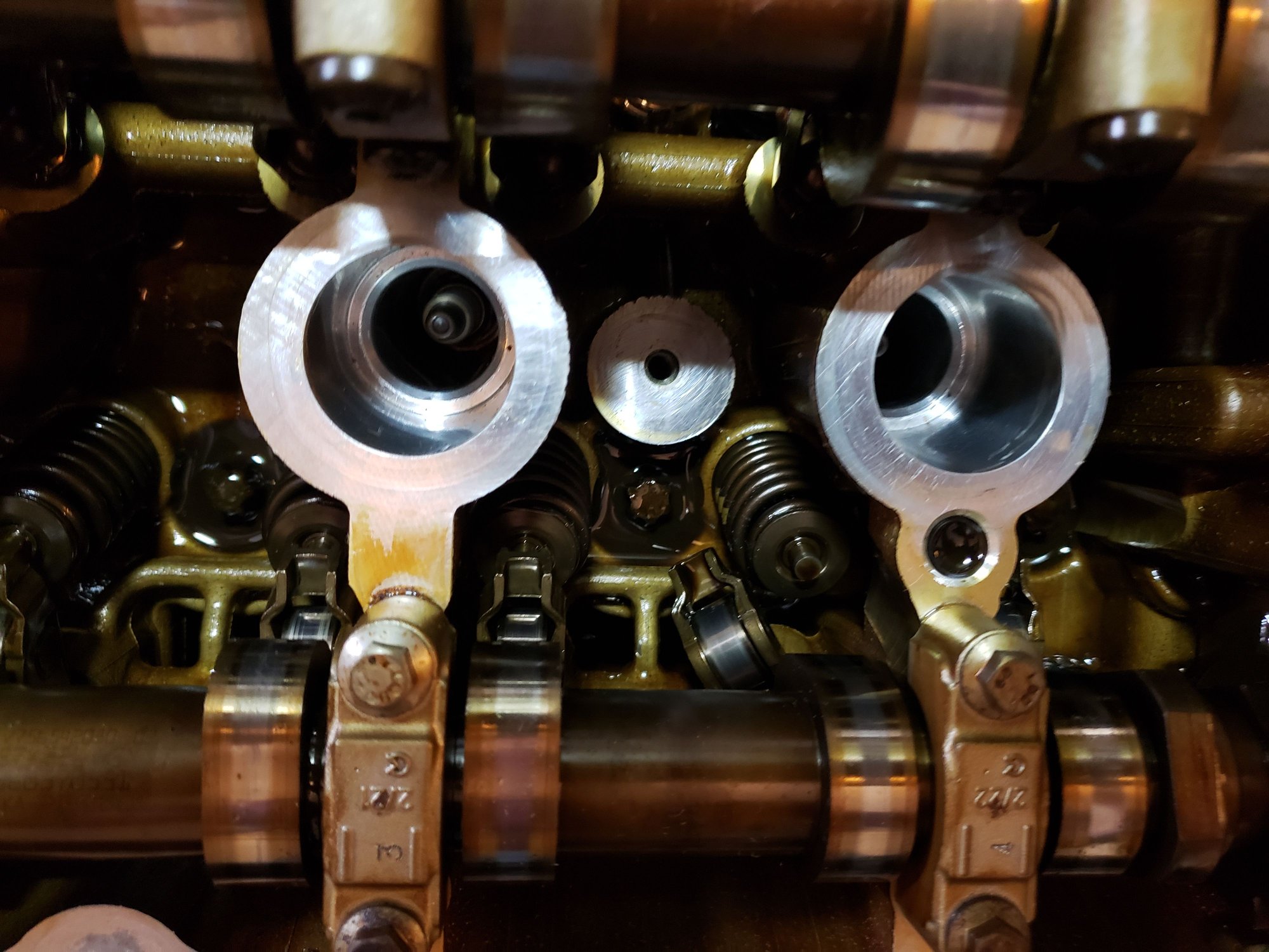

How can i fix this? Would this be causing it not to start? In the center if the picture, you can see a piece came loose and is not where it should be. Im no mechanic, so i dont know what its called. But def6not supposed to be like that.

Excellent....The head is now an N12 head along with the manifold and injectors. The cooling fan is indeed the origianal (N12). The ECU also appears to be for the N12. I was going to ask you about compression test, but you posted a picture of the lifter out of its place...

The head seems to be in good shape. I dont see anything wrong IMO. It is the same one that I bought with the car, I didnt change it out.
Is there an easy way to get this lifter back in place? Would that be causing the engine not to fire?

I thought the car had a turbo and the head was from a 2012 engine?!
if this is the original one, then I would check the timing and then compression. there might be a chance that the valve seat dropped cause the valve to not fully go up resulting the lifter to be thrown out.
you can still position it using a flat head screw driver pressing on the valve and at the same time pushing the lifter in place.
