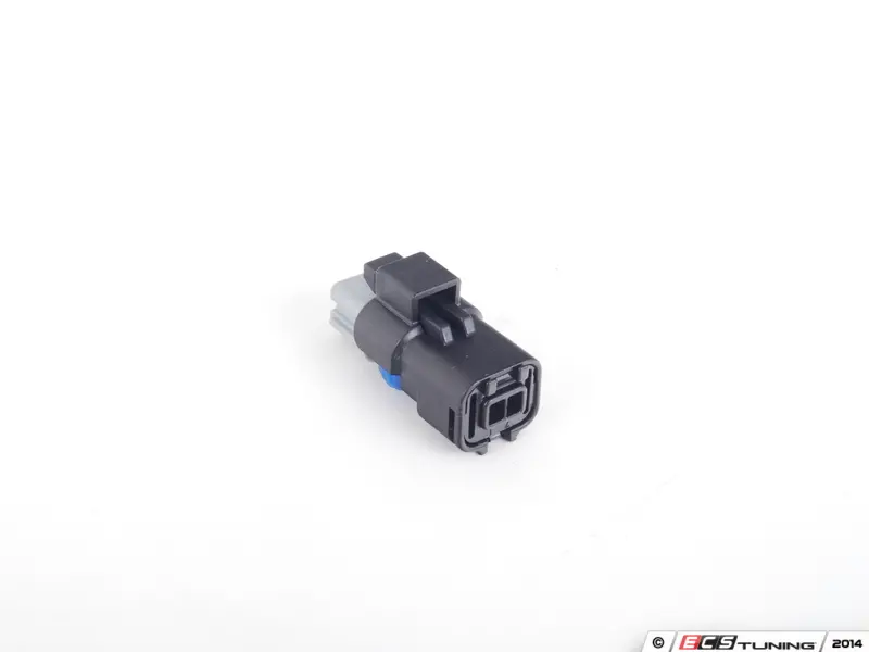

Thanks for the link. Your response made me realized I needed to add one more detail. The piece that screws into the engine appears to be fine (though I'll probably replace it too). It's the connector on the wiring harness that is cracked. Do you have something for that?

Yep, thought it was the sensor side: 12527542850
https://www.ecstuning.com/b-genuine-...h/12527542850/

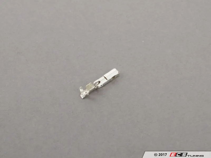

and then is you need the new little metal taps, sometimes hard to get out. Pull that blue tab to the side and try to slide the pins out.
https://www.ecstuning.com/Search/Sit...h/12527543260/ x 1

That looks like what I need. Mine is only a single wire though. Am I missing something?

Yep, in you pic you just use the ones side. You can see in that picture you posted, 2 pin socket but only one side has wire, i adjusted and but x 1 , sorry did not mean to put x 2 for the metal tab.

Plug
https://www.ecstuning.com/Search/Sit...h/12527542850/
Tab
