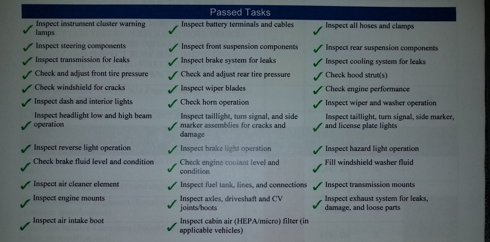

Old Nov 21, 2019 | 04:05 PM
Richieb0y28's Avatar
Richieb0y28
Joined: Nov 2009
Posts: 455
Likes: 14
Old Nov 21, 2019 | 04:06 PM
Richieb0y28
Joined: Nov 2009
Posts: 455
Likes: 14
Report was several pages, so I took pics of every section. Hope this helps.

Thanks there are a lot of things I hadn't thought about.
After reading this report I see why you traded it away.
