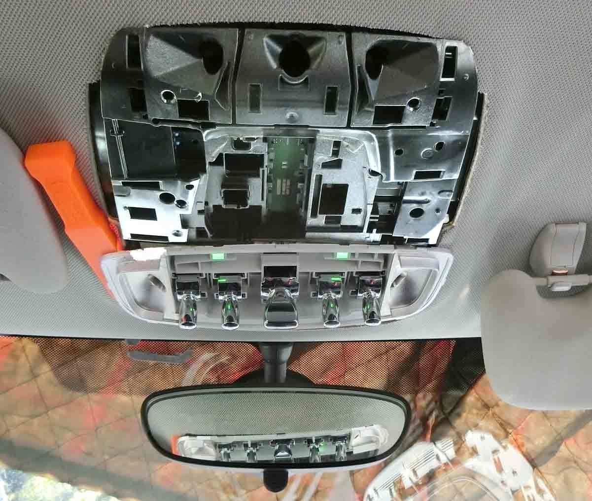

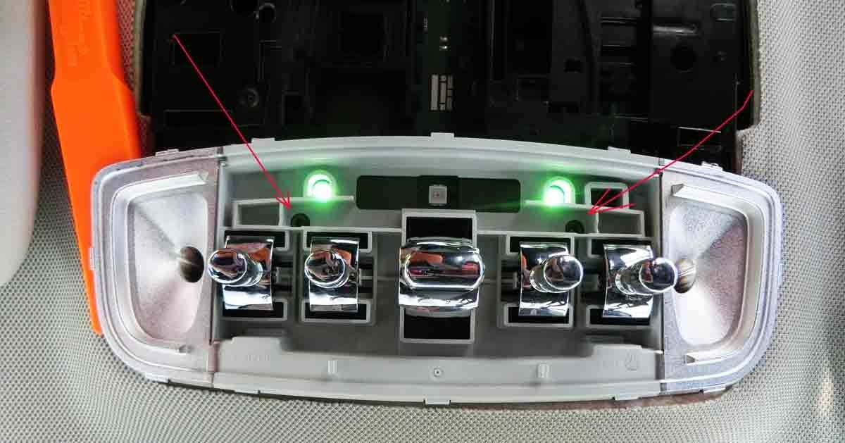

2 Photos of the situation. First the switch plate which has to be out of the way to reach motor - red arrows indicate "screws" which I cannot find any tool that will match them - maybe not "screws" at all.
Second photo is the stuff on the roof with things removed to get at the switch plate which I CANNOT get off,

Yours looks a little different than mine (2007 R55).
On mine, the access plate that has to come off to access the allen hole for the motor is behind
(above on the photo) the switch plate with 2 T20 screws about 1.5" behind switches 2 and 5
on the switch plate.

Following instructions you supplied (THANK YOU !!!) I got to the motor, but looking at the motor, it looks like trying to hand-crank it would be working AGAINST a worm-drive, attempting to drive the driven (output) gear which is not mechanically possible & will just strip the gear.
