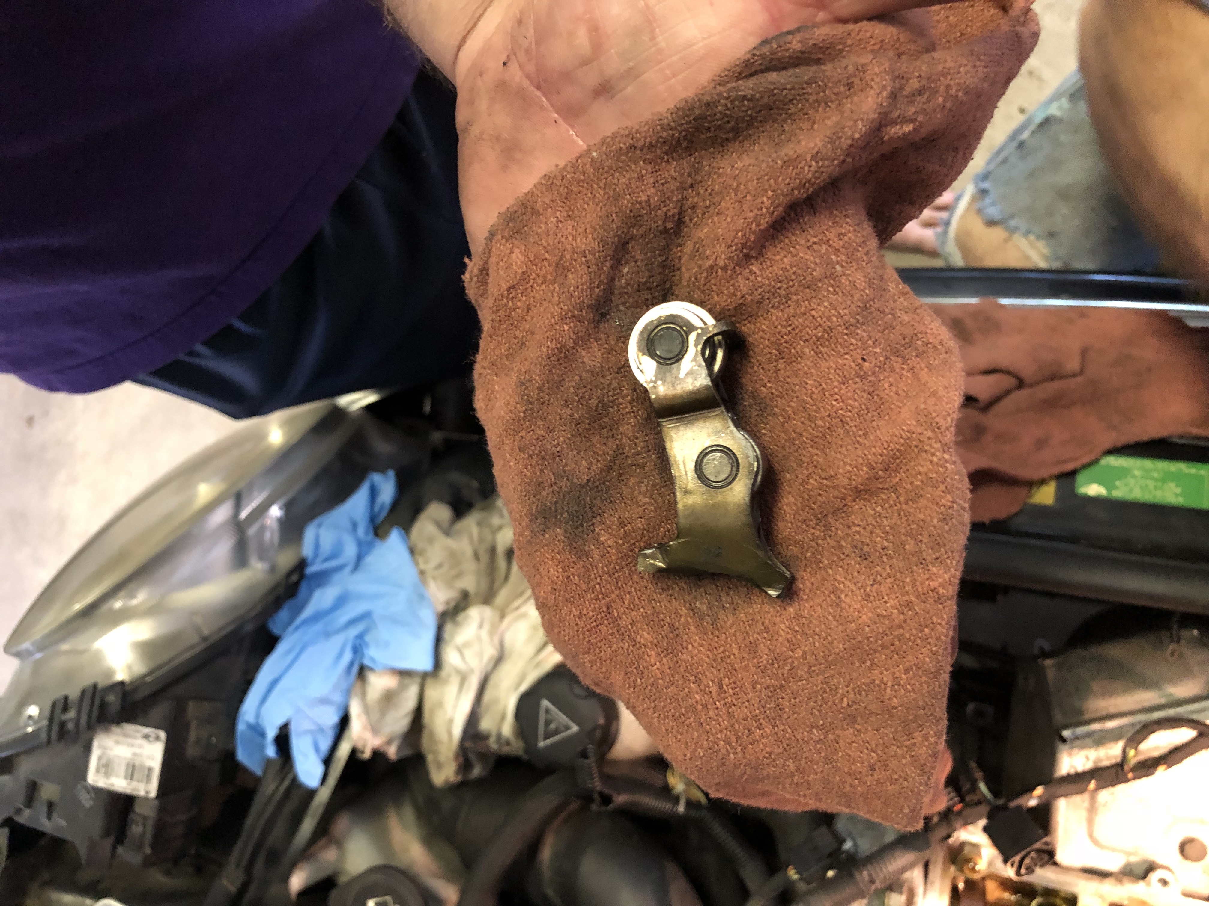

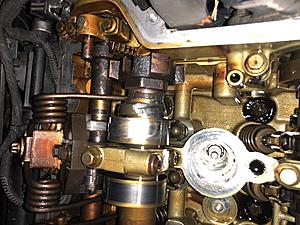

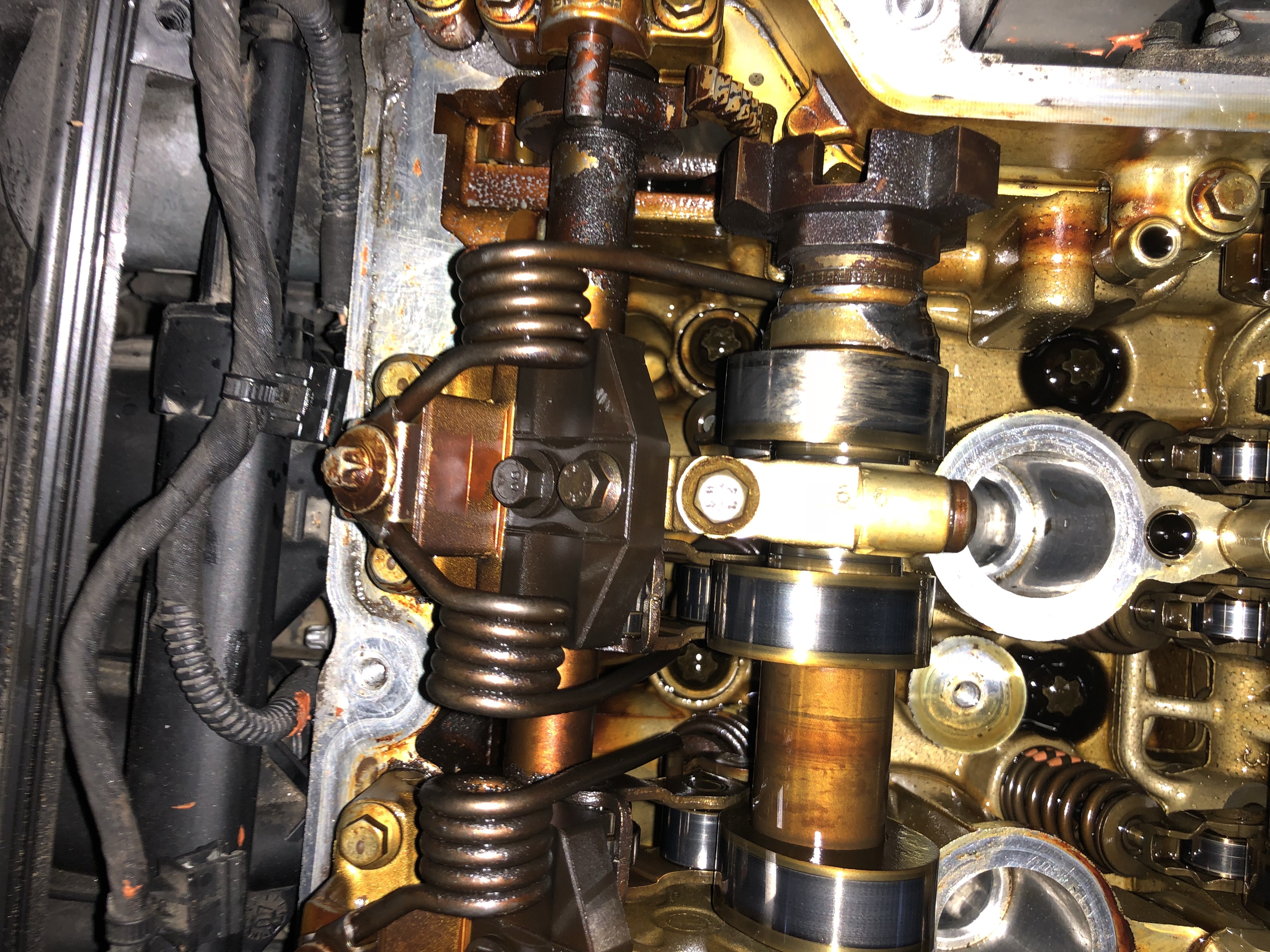

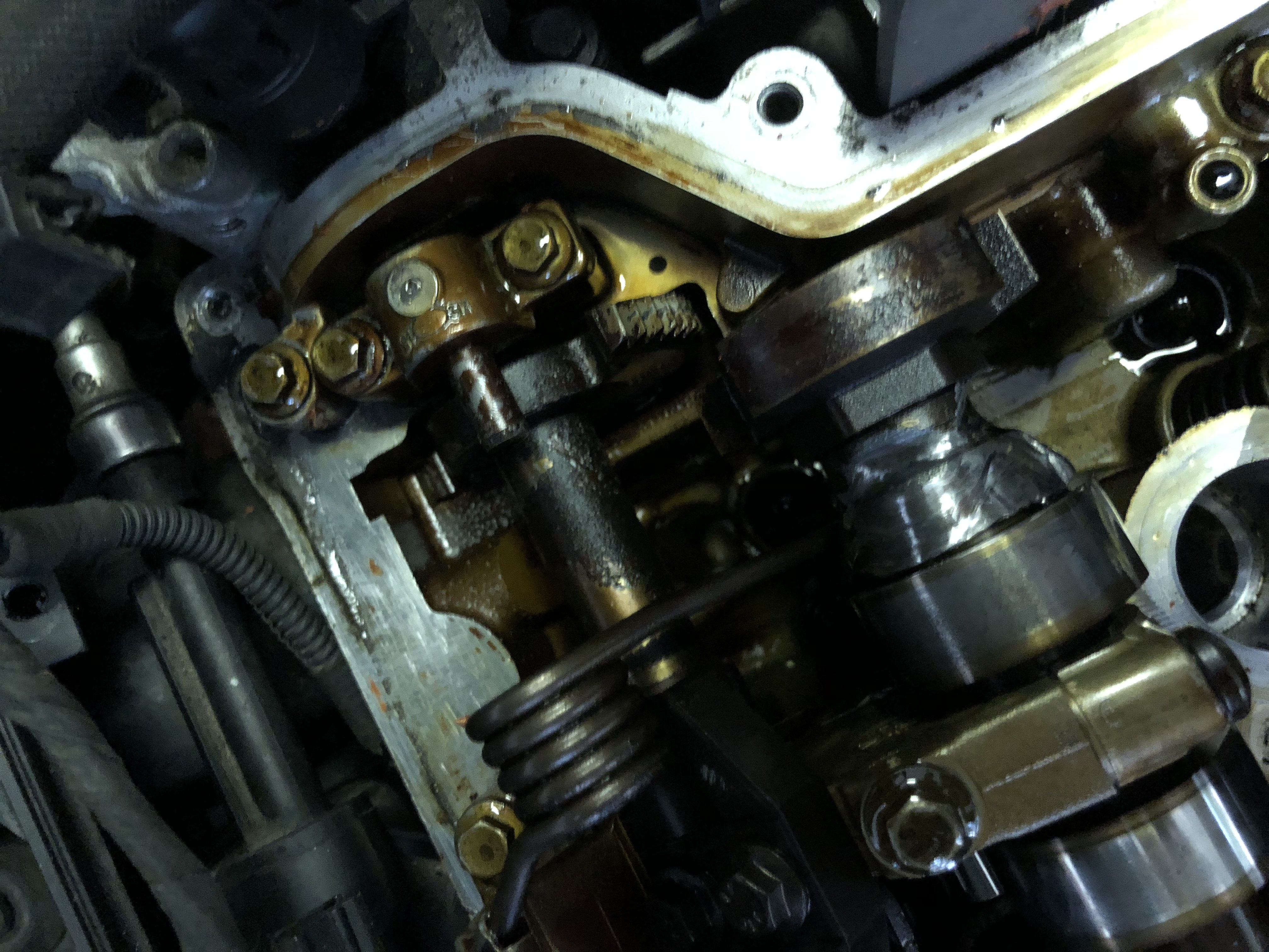

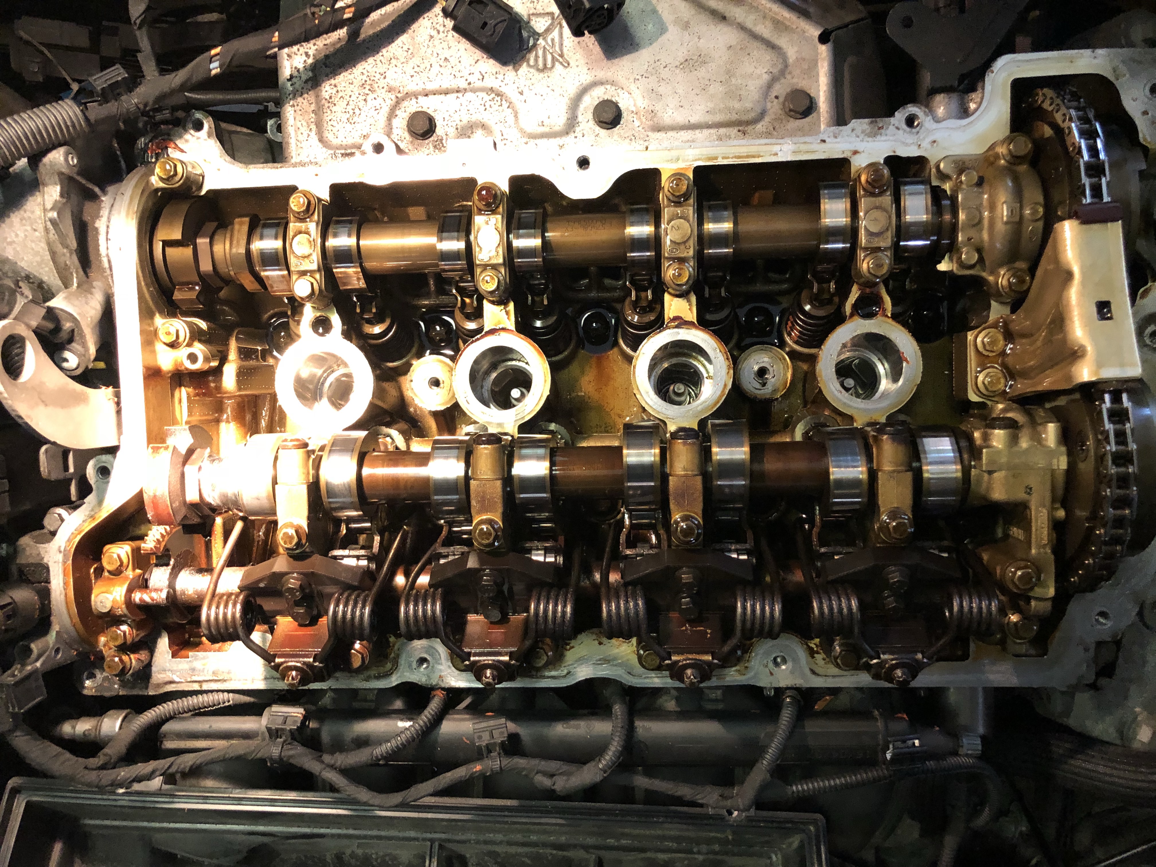

So I took the valve cover off and found what made, most likely, made the clicking noise and hopefully is the stem of all problems. I’m not really sure how what everything is called so bare with me lol. The valve rocker spring which holds up those things (picture of the “thing” in a cloth) was kind of broken and had been rubbing up agains that bar. The “thing” was loose WITHIN the engine.... we all assume that was the clicking and my dad and brother thing that could be (we aren’t too sure and are kind of doubtful) the reason Cylinder 2 is misfiring.
Here are some pictures: (Attached)

Oh man...I had a suspicion...this is some work needed. If the camshaft isnt damaged, you might get away with just reassembling the flown parts. Otherwise, you need another intake camshaft, intermediate lever, and maybe intermediate shaft.
