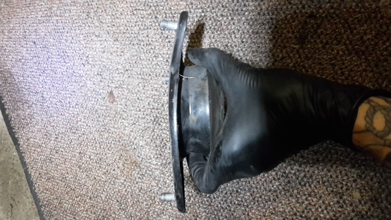

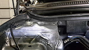

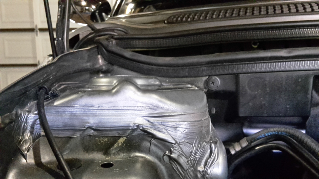

So, after buying my new-to-me Dark Silver '05, I realized that the passenger strut tower was very, very deformed. I'm not a fan of the idea of hammering the sheet metal, so started to think of better, safer, and more efficient ways to fix this issue on R53's. I'm working with someone to build a tool that will fix mushroomed towers without any hammering. It will use an oversized under-plate, a central T-bolt, and a hub up top that fits in and over the strut tower opening.
Is the community interested in renting such a tool? I'll have more photos and information soon.

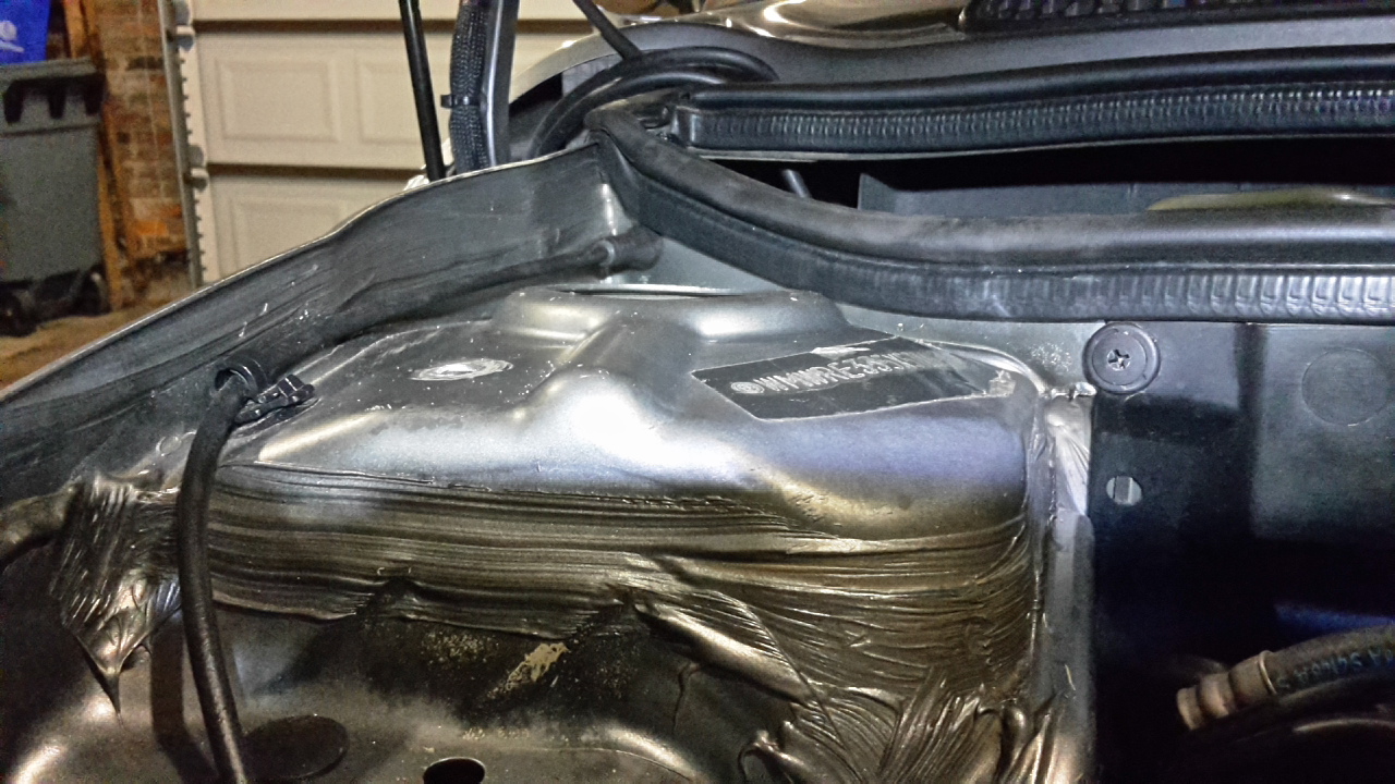

No worries. This is about what I expected, honestly.
As an Engineer, I try to do things the correct (or at least better) way. If everyone is happy pounding on their towers with wood & hammer, that's perfectly fine. I was able to bring a massively deformed tower perfectly flat in 2 minutes without banging on things with a 3lb sledge.
Rebending with a fixture... That "could" be somewhat of a can-o-worms. Depending on exactly how, how much, where the major amount of deformation is, could actually require different fixtures, or at least different sections of a given master tool.
Conversely, you feel that any hammer-wielding amateur can properly assess and straighten the sheet metal better than a tool that covers the entire area of concern, and flattens it uniformly? I respectfully disagree. Currently, there is no better, slower, or more careful solution to flattening towers than this tool or one like it. Though, the bar is certainly set low when the only other solution involves a sledge and wood chunks
"Re-bending" the material is...rebending the material.
This isn't exactly accurate. The Residual Stresses that remain in a material after shaping/forming are not identical across all shaping/forming processes. Agreed though on your points about blindly banging on things with a hammer.
2 Before photos and 1 After photo are attached. Obviously I installed new tophats (and undertower plates AND STD's) following the work.

Point taken. Hands-on field experience and having a firm grasp on the actual science/concepts are not synonymous, nor can they replace one another. I'm actually an Engineering Technician, so I get to play both sides; practical and conceptual.
Anyhow, I just wanted to offer this to the community, because I feel it's superior in several ways to using the wood & sledge technique.
