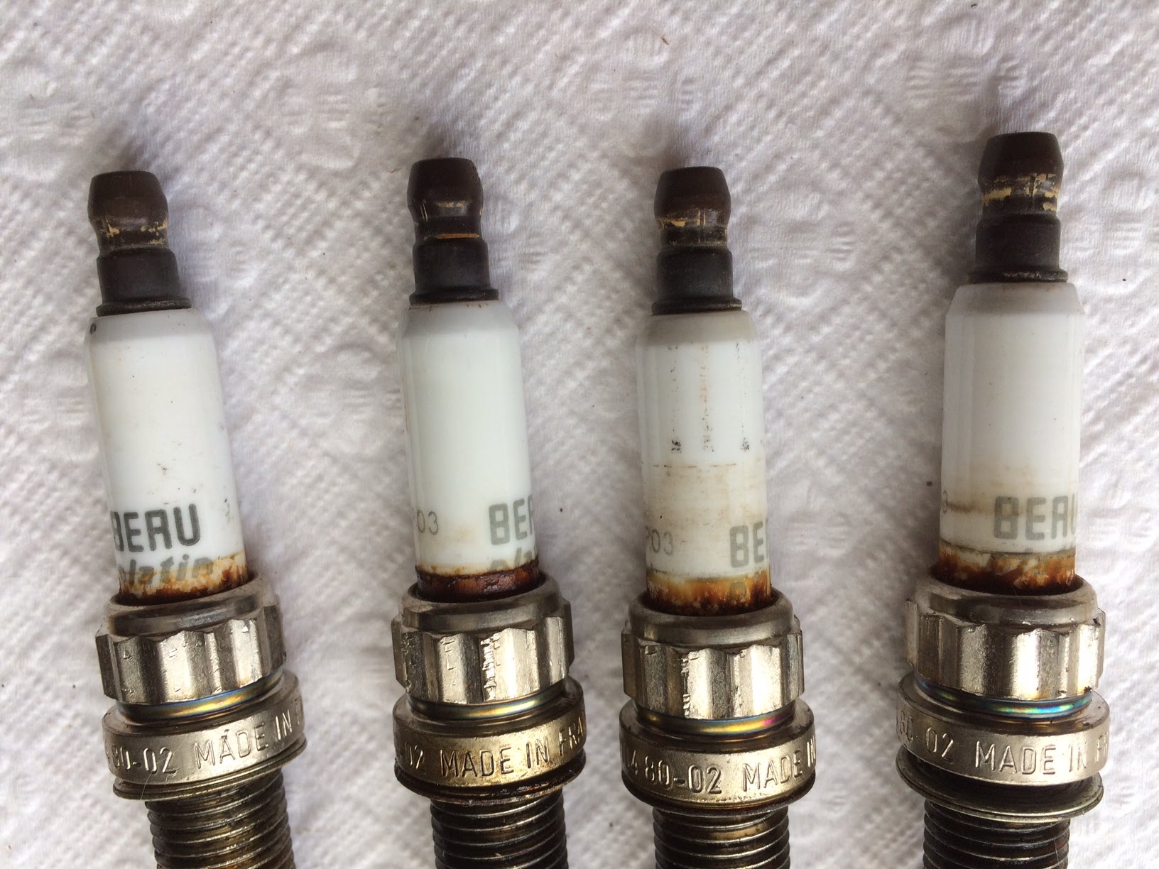

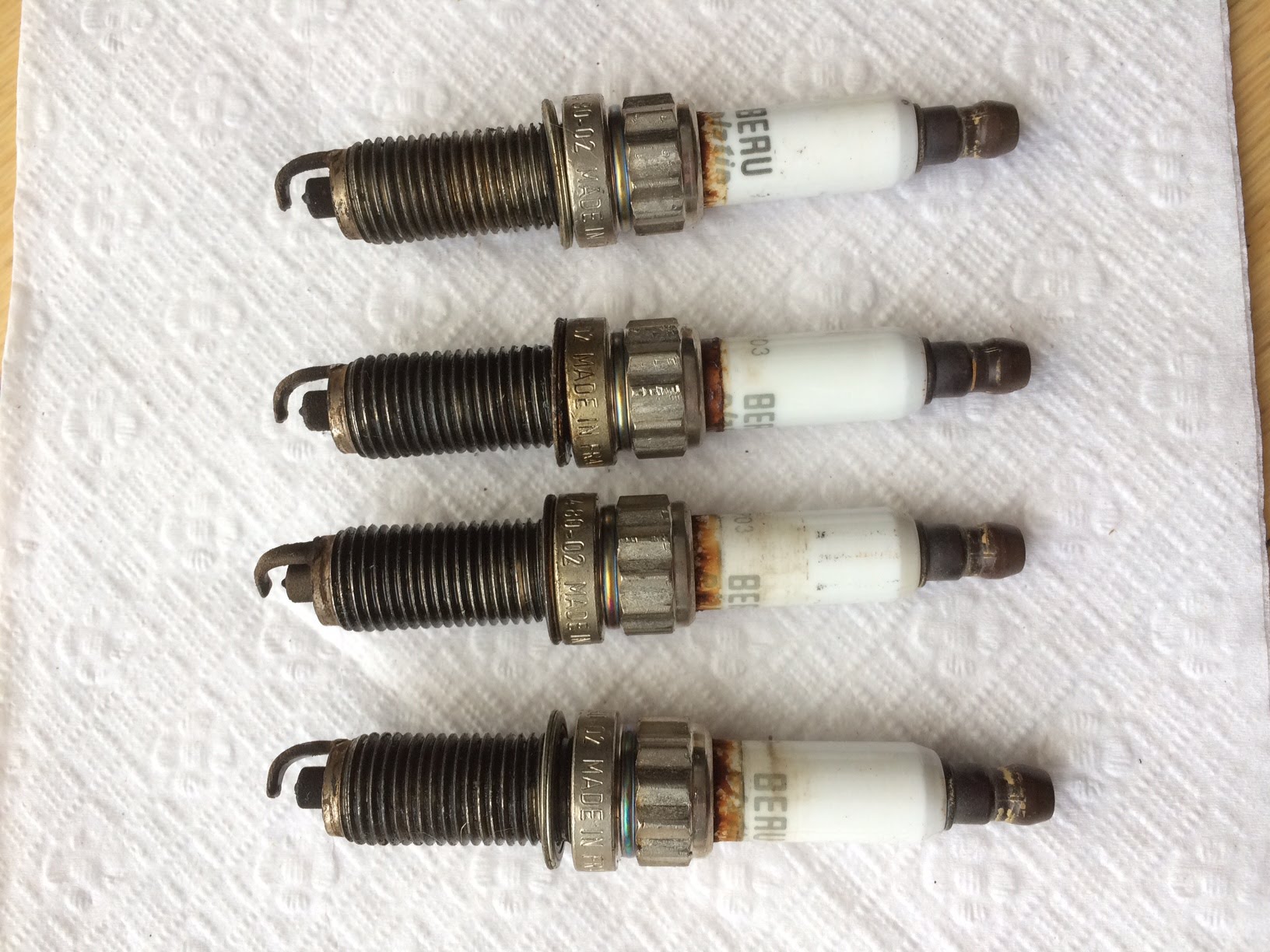

I have a 2009 Justa Auto as well and was having hesitation issues from starts as well. Replaced the plugs and coils and no more hesitations and smoother overall. Easy and quick to do. Parts are reasonable. Check ECS Tuning. I got the Bosch coils and plugs. The original Beru plugs I replaced looked like hell. See photos. I was at 92000kms.

Don't even have to spend any money on plugs first, just inspect them. If they look like kurtsunn plugs above then change them. Lots of online photo's of plugs and what good and bad ones look like.

I changed the plugs. For 50K they all looked pretty beat up. Cylinder 1 spark plug was more oil fouled and the spark plug tube had a bit of oil in it. After the new plugs the car did run better (smoother idle) but the hesitation and lack of low end power did not change much.
