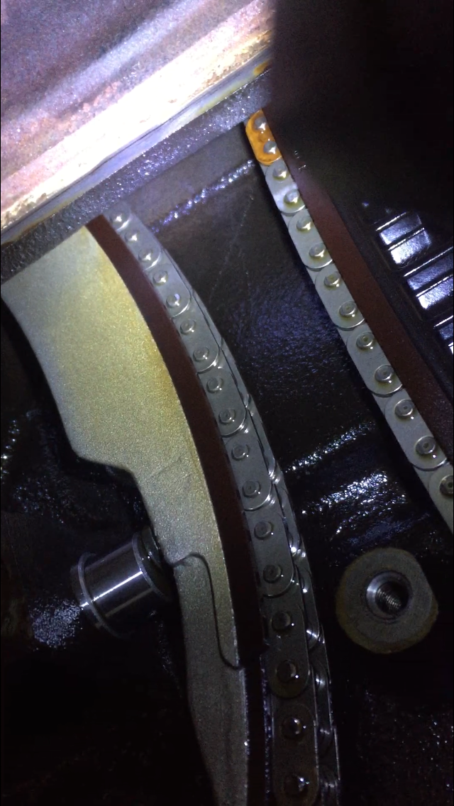

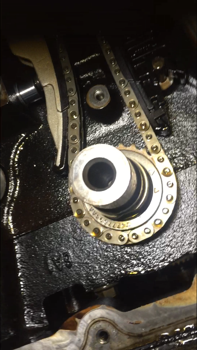

As you see no signs of wear by oil pump
Rails looks fine
Here I noticed timing marks on chain they’re not on the sprocket marks they’re far away so car runs fine without any issues but not sure why the rattle on cold start wondering if the chain is just stretched

First, the marks on the sprockets (crank and cam) will only line up with the chain marks every so many chain rotations. Remember that there are more links in the chain than there are teeth on the sprockets. Could be either four or six revolutions.
