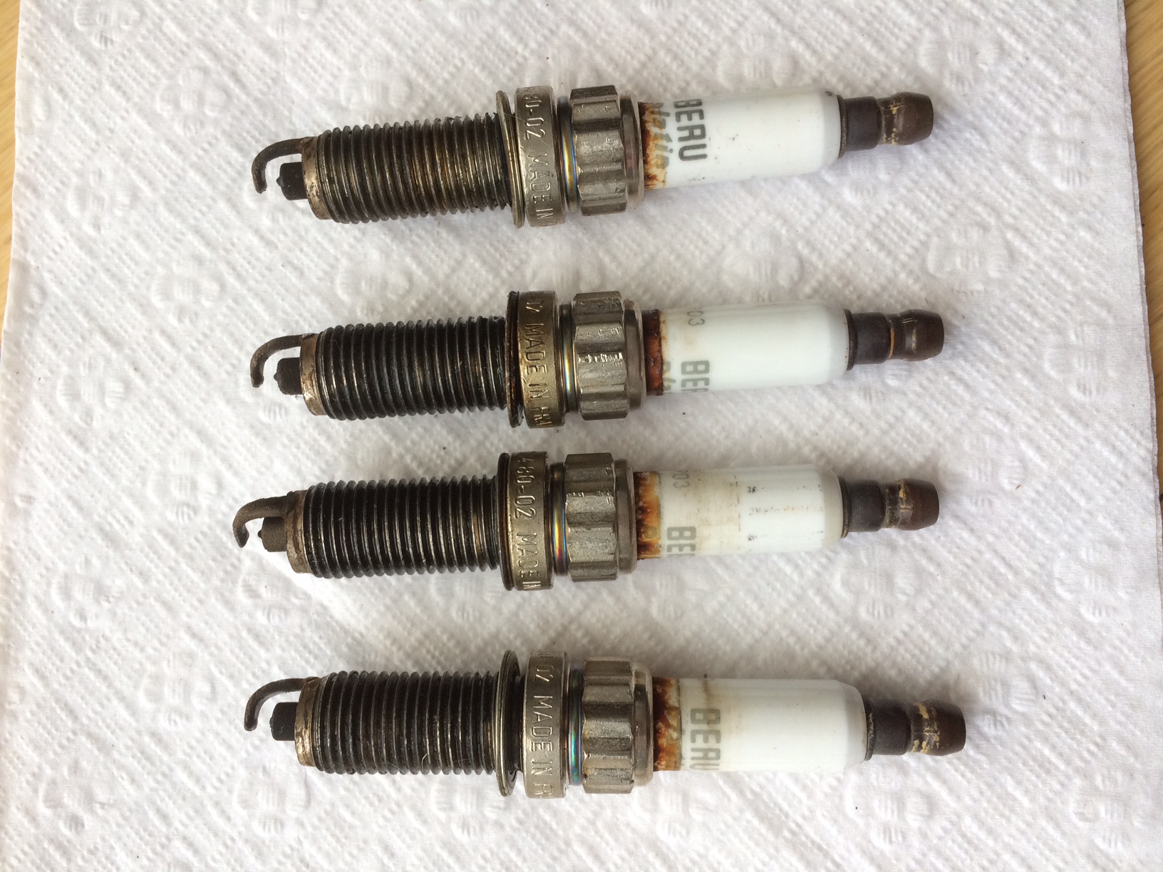

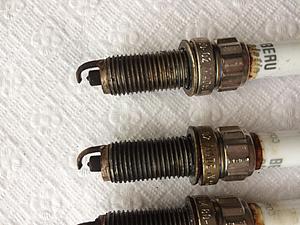

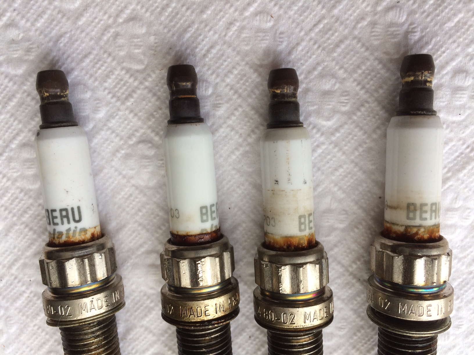

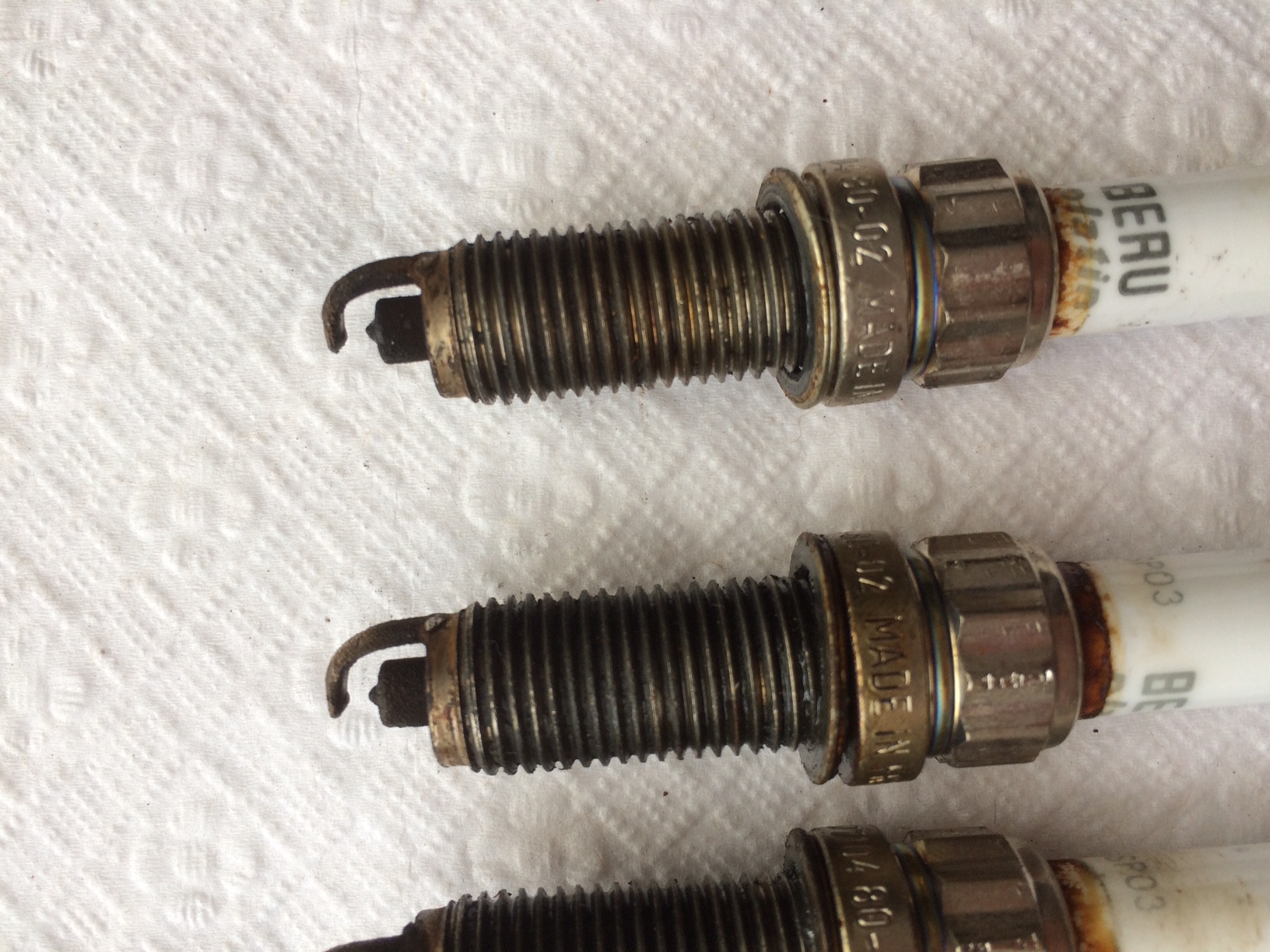

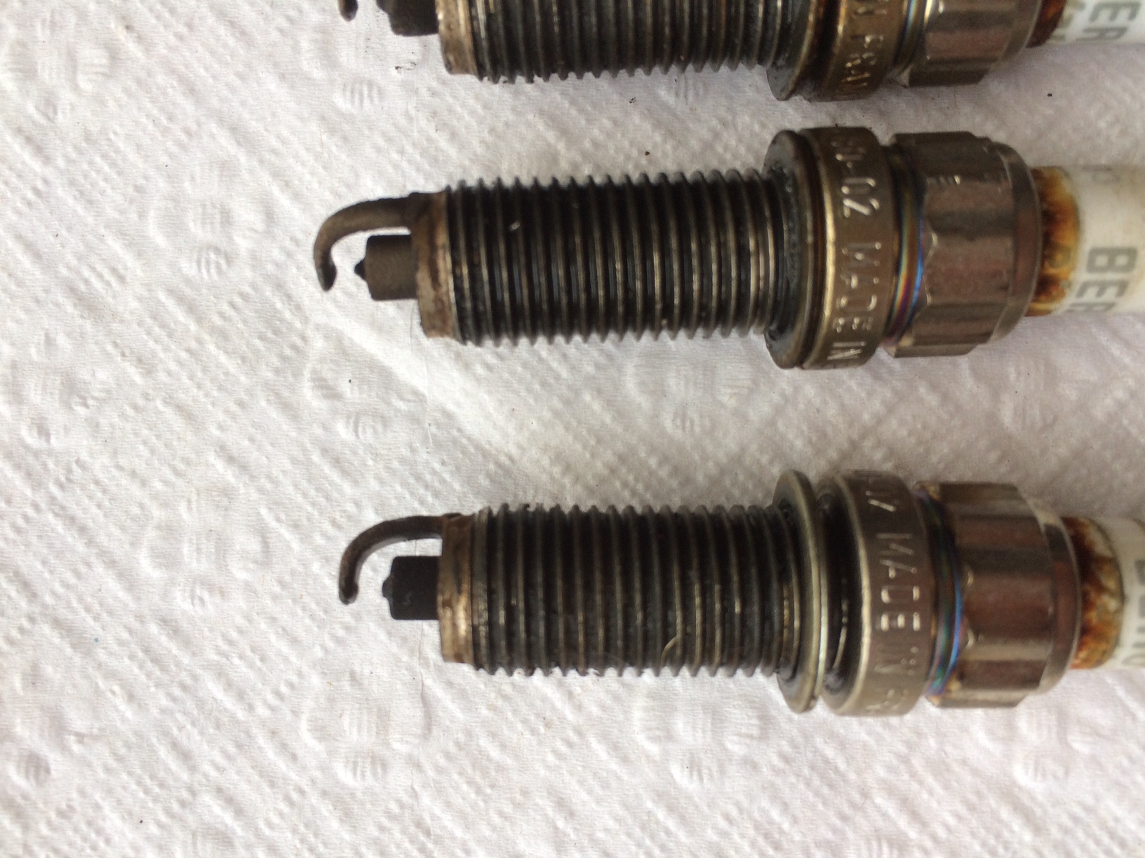

  1. replaced 4 spark plugs (original were BERU, replaced with Bosch) and two coils (Bosch); spark plug in cylinder 1 had a bunch oil in the spark plug well and I tried to get creative getting that out (attached a drinking straw with duct tape to a shop-vac). The other three plugs were fine, but all were highly carbonized and all threads had oily residue; start of white ceramic on each plug had brown staining on them from the oil. The procedure was overall, EASIER than I thought. The oil issues now makes me wonder what the hell the previous owner did - I see in the service records that 2 LITRES!! of oil was topped up only about 4000km from the last oil change .. I highly suspect this caused a lot of these oil issues and possibly the cause of a lot of the other issues I am having..... ;

I've added some pics of the spark plugs, if anyone here can read these automotive tea leaves ....

Those plugs had definitely seen better days

.. which makes me wonder how MINI/BMW doesn't recommend changing them until 160,000 kms (100,000 miles) ... mine only had 92,000 kms.

If you had oil in your plugs then the VCG is likely leaking. If you have p0015, that is a camshaft timing issue. So I would recommend pulling off the VC and checking the chain tensioners for wear or breakage. A new VCG is about $25 and a new VC is about $93 (including the gasket) on ebay. I just replaced my VC with the ebay one and no more leaks. And I got to check the top tensioner and chain while I was in there. It is a very easy DIY.
