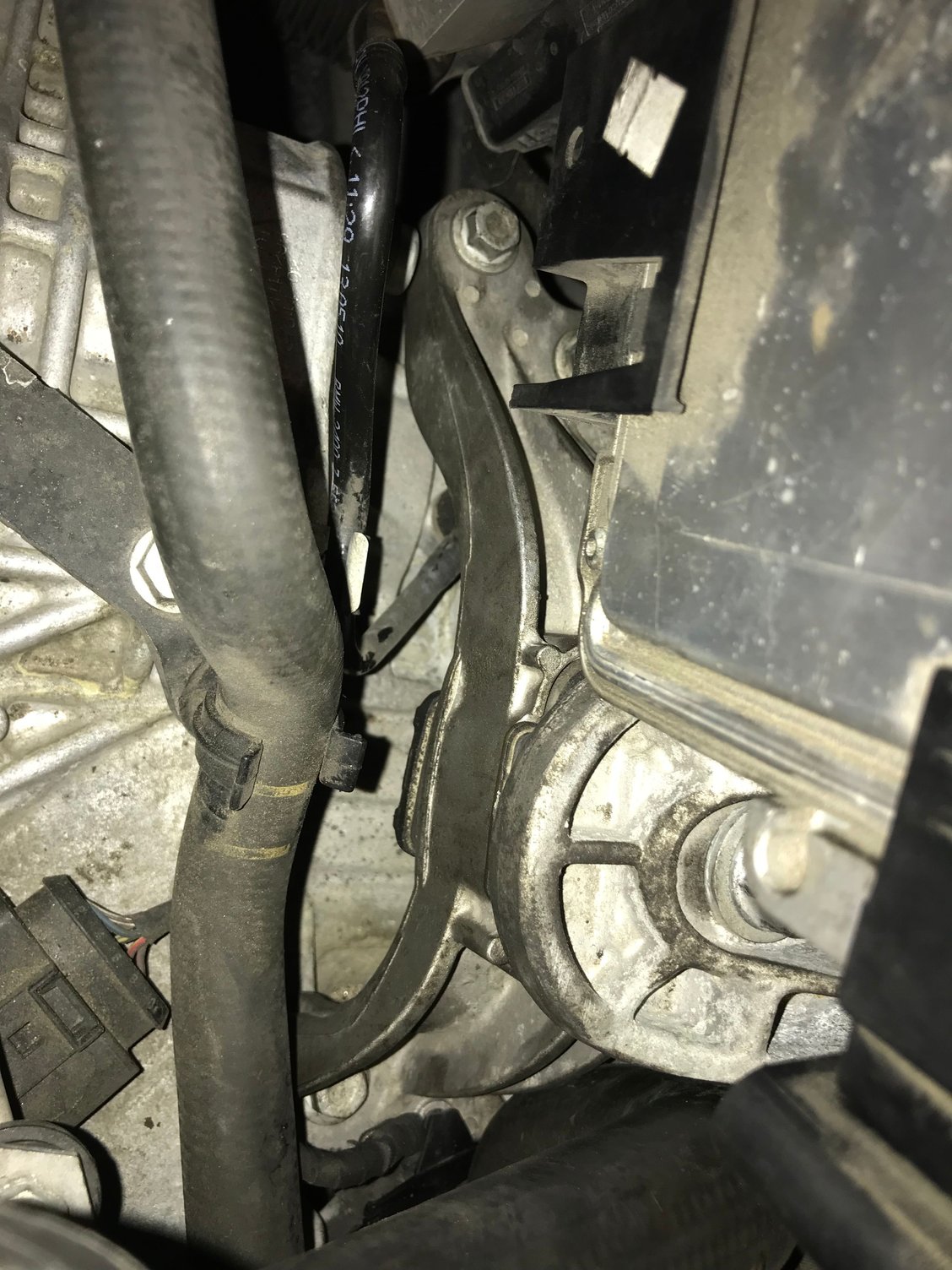

Hello all. Did some engine mount replacements on my 2010 Cooper Base today and after putting everything back together the car is much smoother.
I noticed a plastic hose coming from right underneath the transmission mount And leads nowhere, I’m wondering if I snapped something and I’d sonethibg is missing from that hose or is it just like a breather hose or something. I have attached pictures so if you know what that hose is please let me know, I just want to be sure I did not mess something up, I didn’t unplug any hose while removing the old trans mount
It’s simply coming from the tranny and pointing down like it’s a breather or something

you are correct. it is a breather and go nowhere...you're good

Yes it's a breather vent hose, no need to worry about it
