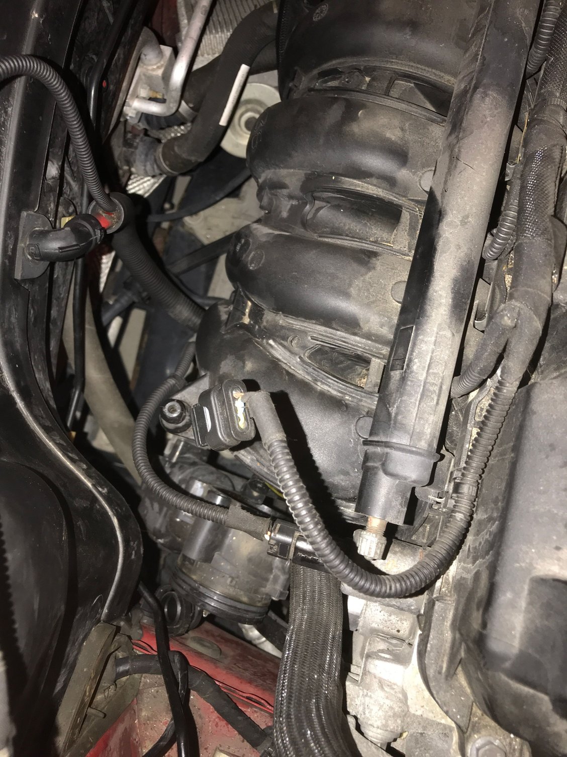

Old Jul 31, 2018 | 10:34 AM
Jace Thompson's Avatar
Jace Thompson
Joined: Jul 2018
So I can get to it from this point...
Old Jul 31, 2018 | 03:43 PM
cornjuice's Avatar
cornjuice
Joined: Sep 2017
Posts: 442
Likes: 38
From: NCAL
it connects at/near the throttle body, but from the drivers side... the hose is shaped like an 'S'
*You will either need to:
A. remove the lower tube to the airbox (coming from your drivers headlight->airbox)..then reach you arm under the airbox and feel for the stupid plastic sleeved connection, just like the one at the head. It is a PITA.
B. jack up the car.. from the bottom, you can see it plain as day (need a flashlight)..its easy to get at and you can pull the entire hose out through the bottom once its disconnected.
Next - you need some materials:
*razer knife
*2x brass NTP->1/2" nipple
*2x 3" straight section of 3/4" (or 5/8") heatercore hose or other rubber type, so long as its oil resistant
*4x 3/4" hose clamps
*3' of 1/2" heatercore hose or other rubber type, so long as its oil resistant
*2x 1/2" hose clamps
Using the OEM hose and your knife.. carefully cut the hose off of the end connectors. Slip your 3/4" hose over the nipples of the salvages connectors & hose clamp. Insert the brass NTP end into the 3/4" hose and clamp.. then fab up your 1/2" hose to connect the 2x end. Once youre done.. reinstall. You will never have to worry about that stupid hose again.
Old Aug 12, 2018 | 01:17 PM
starbby's Avatar
starbby
Joined: Sep 2009
Are you talking about a "justa" N12 or an MCS N14? This hose is completely different between the two. I'm having the same issue and there is no way you can see the intake manifold end of this hose from underneath or above. Also there is an electrical connection on the N12 hose at the intake manifold side. I don't see how to get at it without completely removing the intake manifold.
Can someone verify how to do this on an N12?
