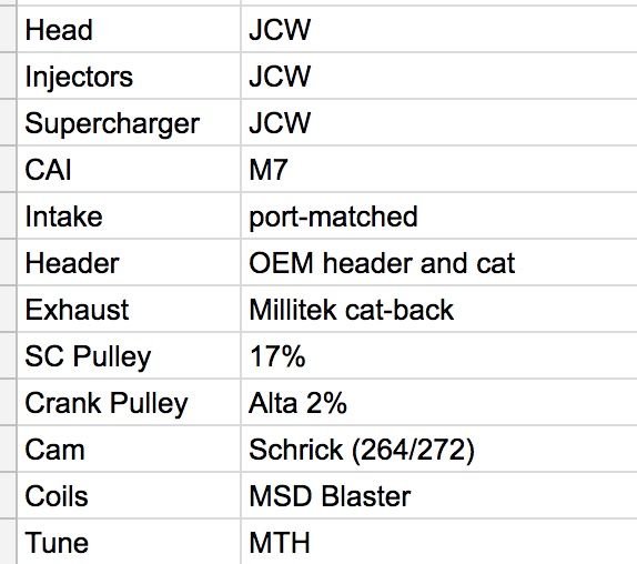

The car is modified as follows:
Any thoughts and/or suggestions? This is beyond frustrating...

Just a warning. You may not get much if any sympathy from a referee if you mention the mod's.

I took it to the dealer and they flashed on the 'updated' OEM tune and then it passed immediately.
Note to self: if getting a new tune, be sure that the OEM tune can be reflashed to pass smog.
