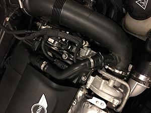

Hey all,
New to this forum. Just got my Mini, A 2012 R56 S!
So I replaced the thermostat housing because of a leak but now I can't get rid of the ETC P053A: Positive Crankcase Ventilation Heater Circuit Open.
I've tried ensuring sure the plugs are in place, zip tied them, applied a bit of RTV to the hose connections... No luck. I've attached some pictures, I just want to see if anyone has any advice before I go ahead and spend $150 on the new hose. Also can someone verify that I'm looking at the correct hose & connection?
P.S. what is the function of a PCV 'heater?'
Thanks,
Bob

First time I changed my t'stat housing, I managed to switch the PCV heater connector with the coolant temp sensor connector --- very flimsy connector keys! Heater voltage blew out the coolant sensor, so it had to be replaced. Anyhow, check the connector "keys" to ensure you have the connectors installed in the correct location.
PCV heater is right next to the turbo air inlet --- on the one inch hose at the elbow / tee plumbing. The heater is used to heat air going into the valve cover --- replacing air that is sucked into the intake manifold.

Okay so just to confirm - it is what I have indicated in this attached picture?
Attached Thumbnails P053A PCV Heater Circuit Open-screen-shot-2017-10-19-at-3.47.44-pm.png
Old Oct 19, 2017 | 04:06 PM
oldbrokenwind's Avatar
oldbrokenwind
Joined: Mar 2011
Posts: 1,945
Likes: 203
From: Northern NV
Yes, that's the PCV heater.

Okay and what are these connector 'keys' you speak of? A color coding or something?
Old Oct 19, 2017 | 04:49 PM
DoodlesTJ's Avatar
DoodlesTJ
Joined: Oct 2017
Posts: 9
I can confirm all of my plugs are in the right place. Unless the other end of the connector - wherever that is? Is disconnected? Any ideas?
Maybe the hose is shot? But it seems fine to me
