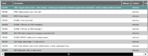

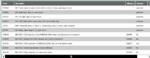

I wasn’t comfortable with the INPA diagnostic results as the software seems clunky and wasn’t sure I was using the software correctly / found all the fault codes. I installed a different diagnostic software (ISTA-D) and found fault codes listed in the attachments.
After clearing the codes, I tried to start the engine (still didn’t start) and got the following 3 codes that were also present before the clear:
• 000341 DME: Camshaft sensor (bank 1) –measuring –range or power-output problem and
• 005E19, 002096 DME: Oxygen sensor (bank 1, after catalyst) – exhaust-gas composition indicates oxygen-sensor fault (bank 1, catalyst)(mixture too lean)
• 005E19 ABS-DSC: CAN data error from DME/DDE (DSC lamp on as long as error is present)
Based on the 000341 fault I have order a camshaft position sensor – hopefully that will resolve all 3 codes.
