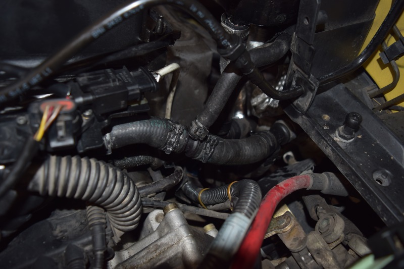

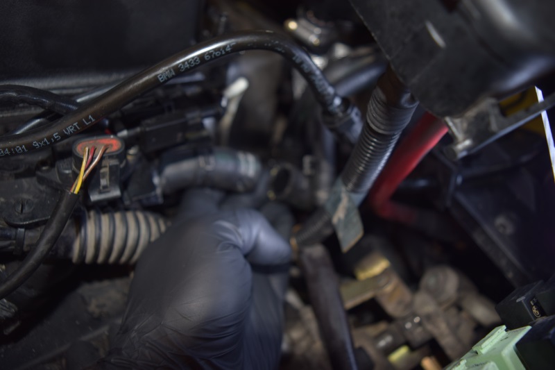

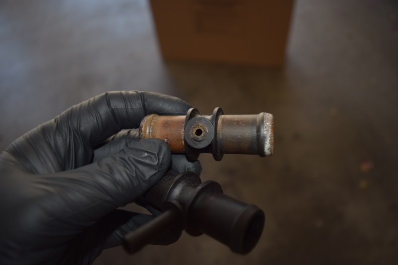

Have you looked at the plastic T-connector behind the thermostat housing? Its down below the air filter box towards the back. It is a standard coolant line with a T-connection, the T-connector leads back to the coolant expansion tank. The small tubing is known to snap/crack over time.
Pics from my exercise:
Old vs New
Pic is fuzzy but follow my fingers back to the gap in the coolant line
New connector installed and everything secured
Part Number if need be… 17127518614
REALOEM WEBSITE LINK
