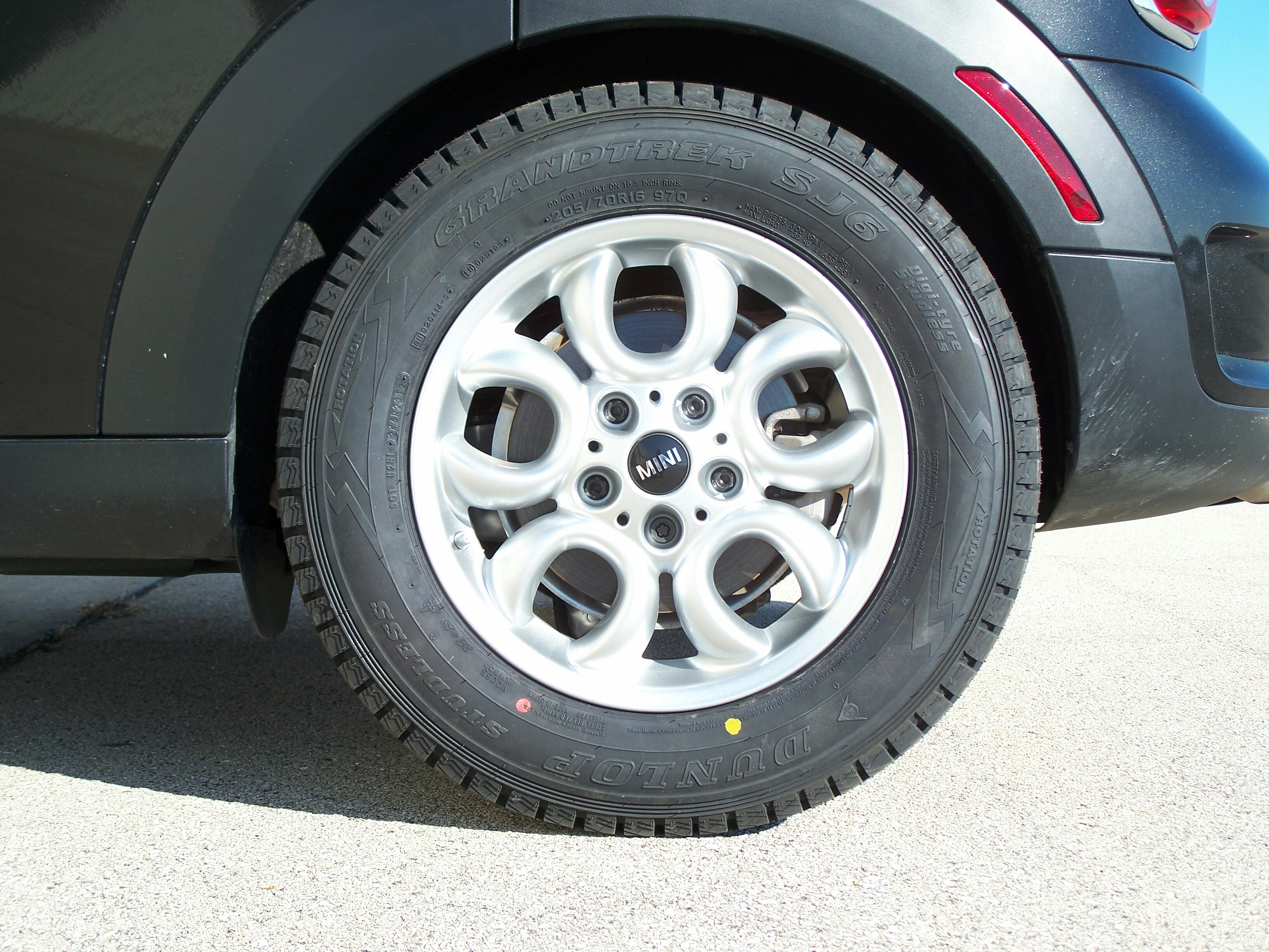

i bought mini oem 16x6.5 et46 euro alloys from ecstuning.com (they also sell 16x6.5 et46 mini oem steelies but they do not accept tpms sensors ... but they are about 1/2 the price of the alloy wheels)
i run dunlop grandtrek sj6 winter studless ice and snow all terrain tires in size 205/70R16
the tires are 1.4 inches taller than the stock tires netting almost 3/4 inch additional ground clearance
the tires do not rub at all under any condition
Attached Thumbnails Winter wheel and tire ?'s-100_1922.jpg   Winter wheel and tire ?'s-100_1910-001.jpg   Winter wheel and tire ?'s-100_1920.jpg   Winter wheel and tire ?'s-100_1918.jpg   Winter wheel and tire ?'s-100_1912.jpg

^^ that's a good set up and saves you from pot hole damage on the high sidewalls. But your not as heavy as the steelies.
Currently looking for winter tires for my 2012 CM. Trying to find the maximum height a stock r60 can handle. Your 27.3" tires seem to be the tallest I've seen so far.
Have you had any rubbing since this post?

been runningg this setup since winter 2012/2013, no rubbing under any circumstance.
i have the factory sport suspension, 10 mm lower than standard suspension
