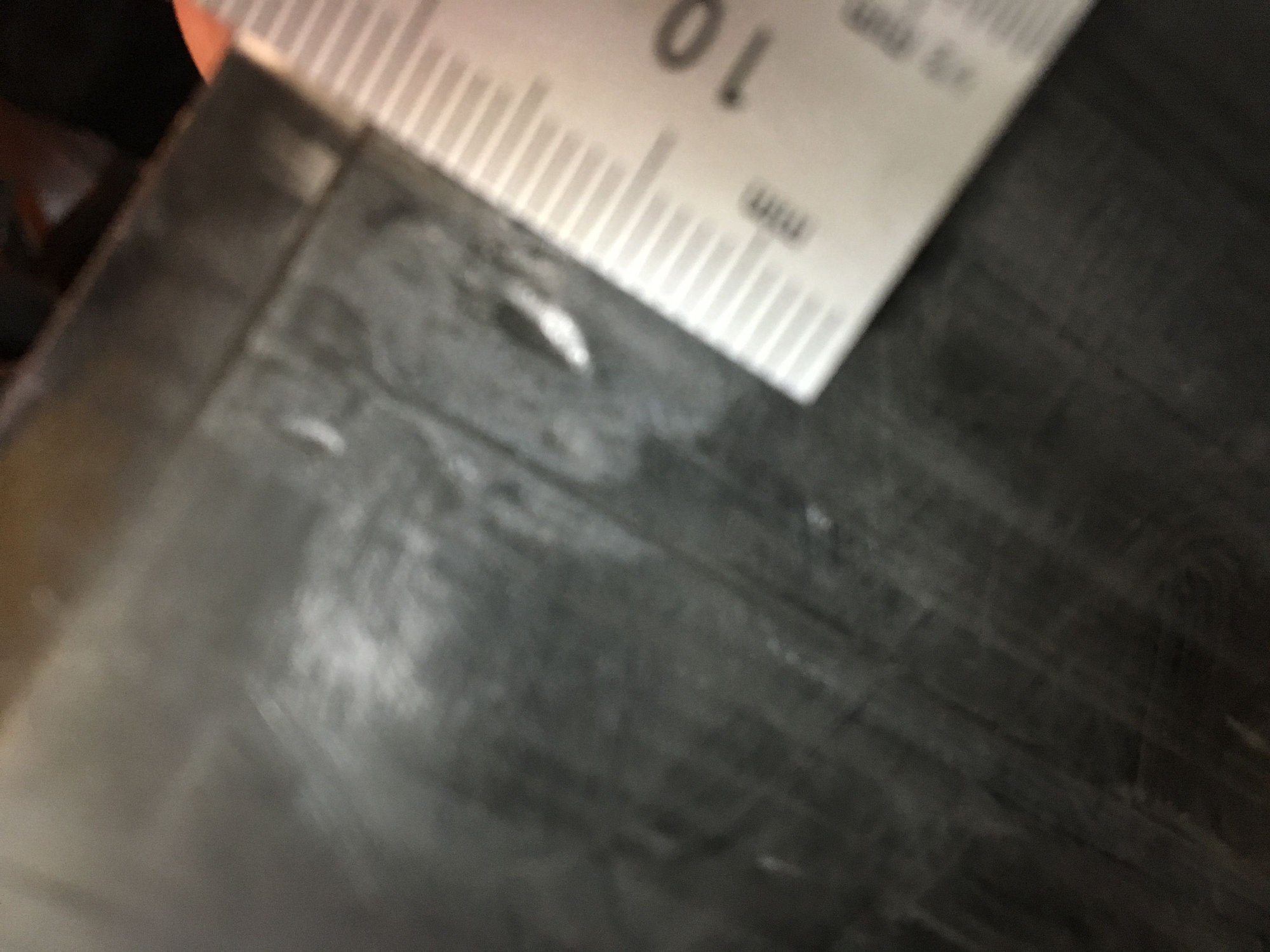

I’ve had engine trouble recently with my 2007 MCS. Long story but; no compression in #3 cylinder, burnt piston. Small gouge in cylinder wall, perhaps 8 mm long, just below where the rings would sit when the piston is at TDC. (Too deep to hone out) I’m sure I could put another piston in and run the engine the way it is but I’m doubtful about how long it would last………I would have wicked blow-by at the damaged area which is about when the piston is seeing peak combustion pressures.
I have considered boring & oversize pistons but I am hoping to do an economy repair and have a reliable driver.
