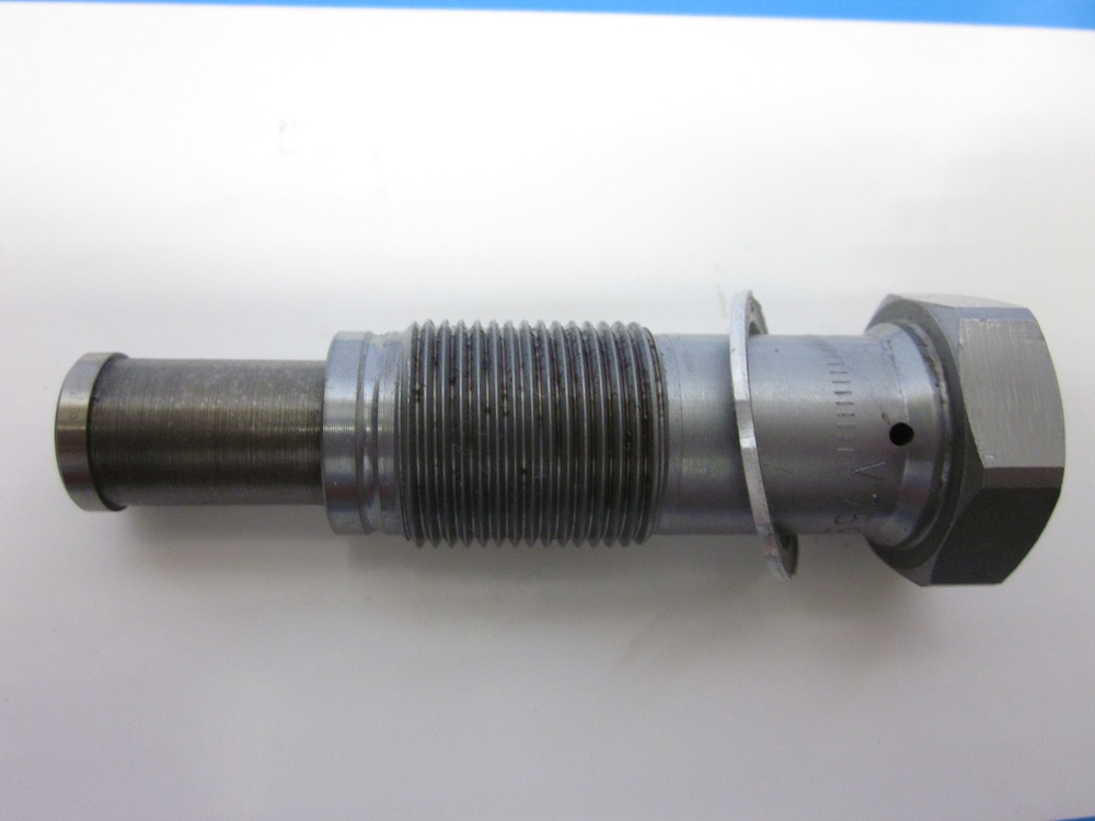

Oldbrokenwind - I saw your post on a another forum regarding a similar situation. With a 2010 MCS with the only symptom of a slight external leak from the tensioner, the remedy could be as simple as replacing the gasket on the tensioer and re-torque. Or, replace tensioner since removing anyway.?
In the other thread it was pointed out that there were some 2010's that did not have the tensioners installed to proper torque.

Here's a pic of my tensioner. You can see that there's no other area except the o-ring, or very soft and fancy washer, for a leak to happen. The hole / indent on the outside surface (not shown) is for centering the item when being fab'd --- it doesn't go thru. OK, mine is an '07 vintage, but it's not likely to have changed enough, structurally, to have any other source for leaks.
As for replacing it "while you're in there", that's a subjective call. Spring and internal seals could deteriorate over time and miles. It's question of convenience and budget.
