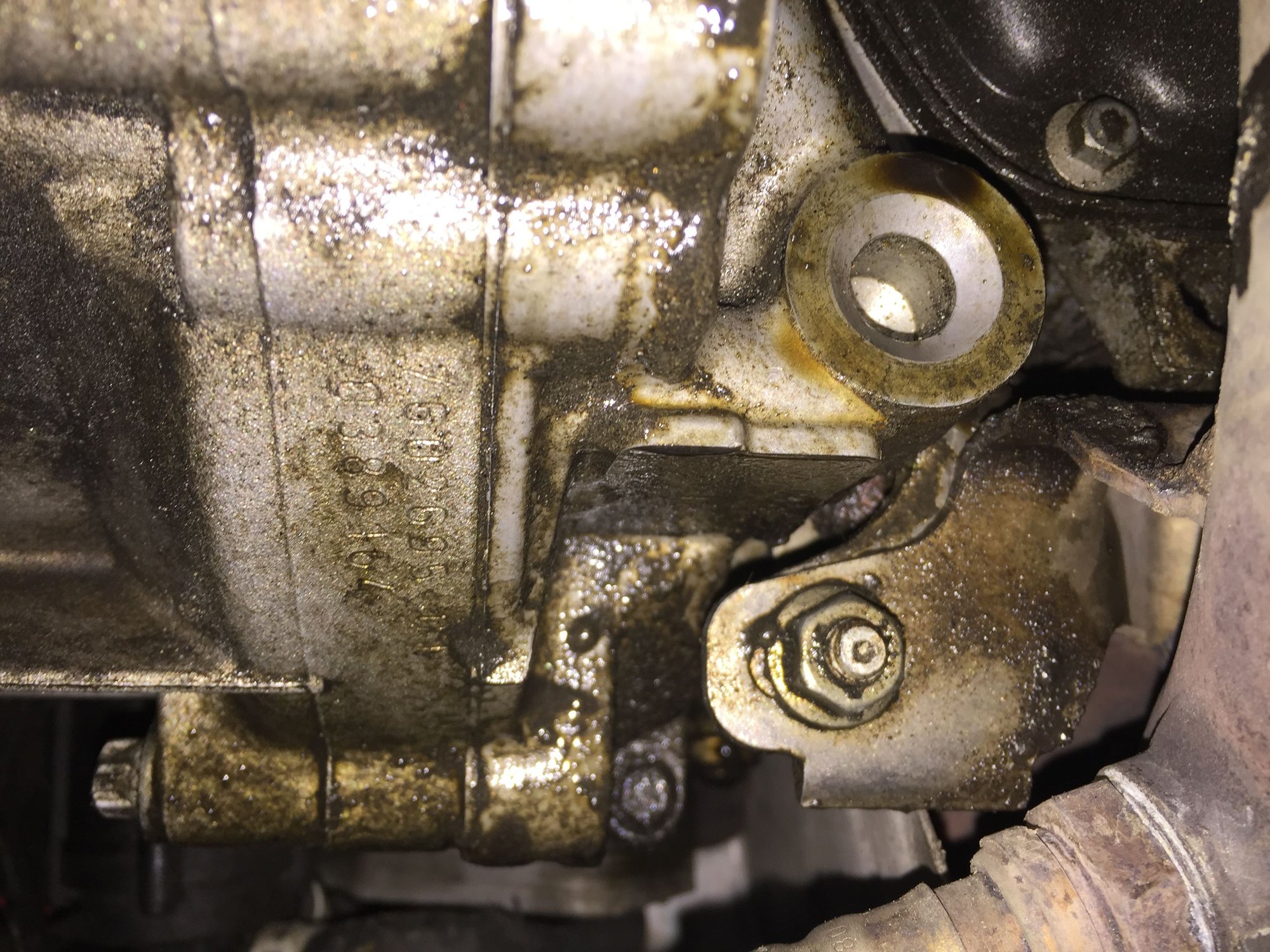

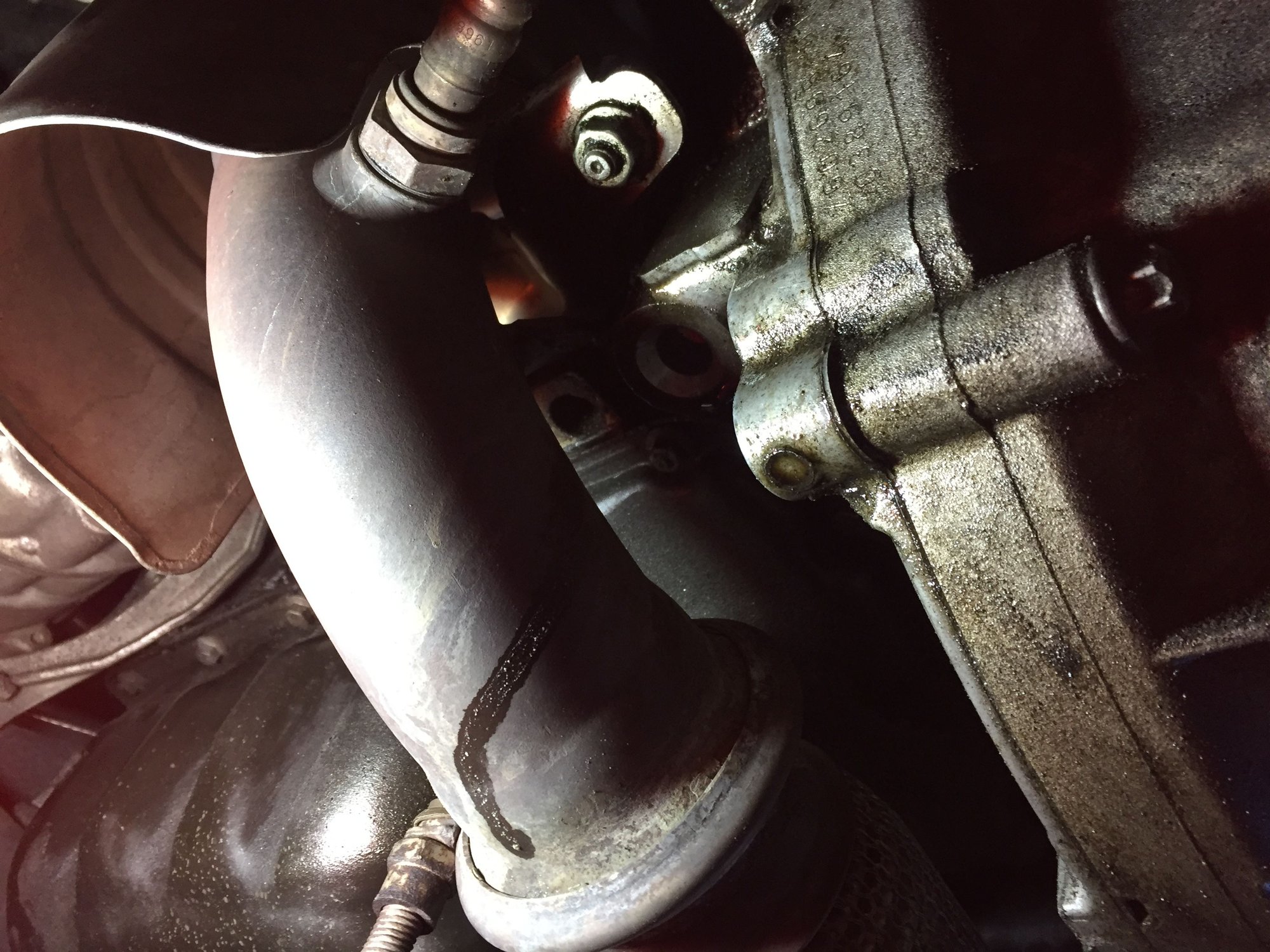

Just noticed drops of oil on the floor and pinpointed the burning smell to oil burning off the downpipe. Stealership said it's the oil pan but I don't think so. Oil is coming from the top. Need ideas as to where!
Pics from underneath the car: 09 MCS

Nevermind, looks like the oil feed line. The bottom connection most likely as the line connected to the turbo is clean.

Pics look like Oil Filter housing is leaking..... while you have it in service position you might as well replace all those gaskets.... mine was really leaking a lot when I replaced turbo.... I fixed everything.
