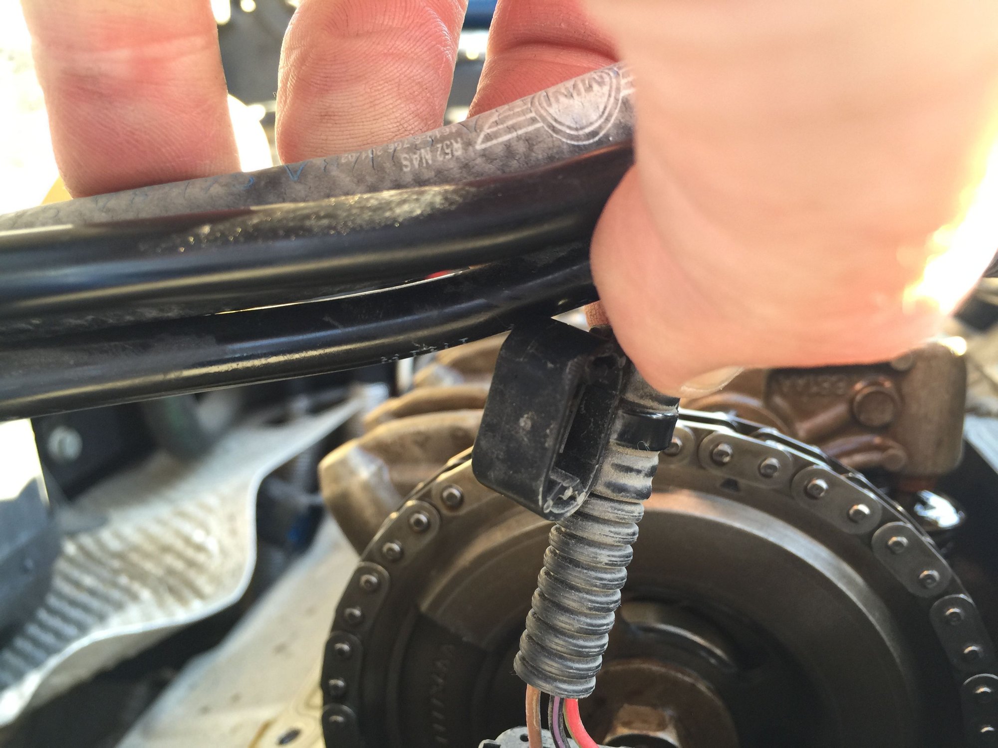

I may have found the problem. No matter how many times I turn the the engine over I cant get the arrow and the copper link to line up.

Old Aug 1, 2016 | 07:47 PM
Kayode Ige's Avatar
Kayode Ige
Joined: Jul 2016
Posts: 43
Keep turning it. It will eventually get there but I don't believe it'll tell you much until you take off the timing chain cover/oil pump and make sure those are lined up as well. Check the timing chain guides if you can from above and pull the tensioner and make sure it functions as it should.

I had it lined up once. The chain seems sloppy. I wanted to post a video, but cant figure out how.
If you can feel any slop I would imagine the timing has skipped. Lucky you! From what I saw the MCS is non interference as all of my valves were perfectly ok. First time it skipped I had reduced power, second time car just died on the highway but not damage to the head or valves.
If I were you id pull the tensioner out (19mm, easy to get to and plenty of diy's out there) and see how it feels. It should be fully extended when you pull it out.
Thanks. Sounds like I need to do that and pull the timing chain cover, but if I do that I might as well replace the timing set.
