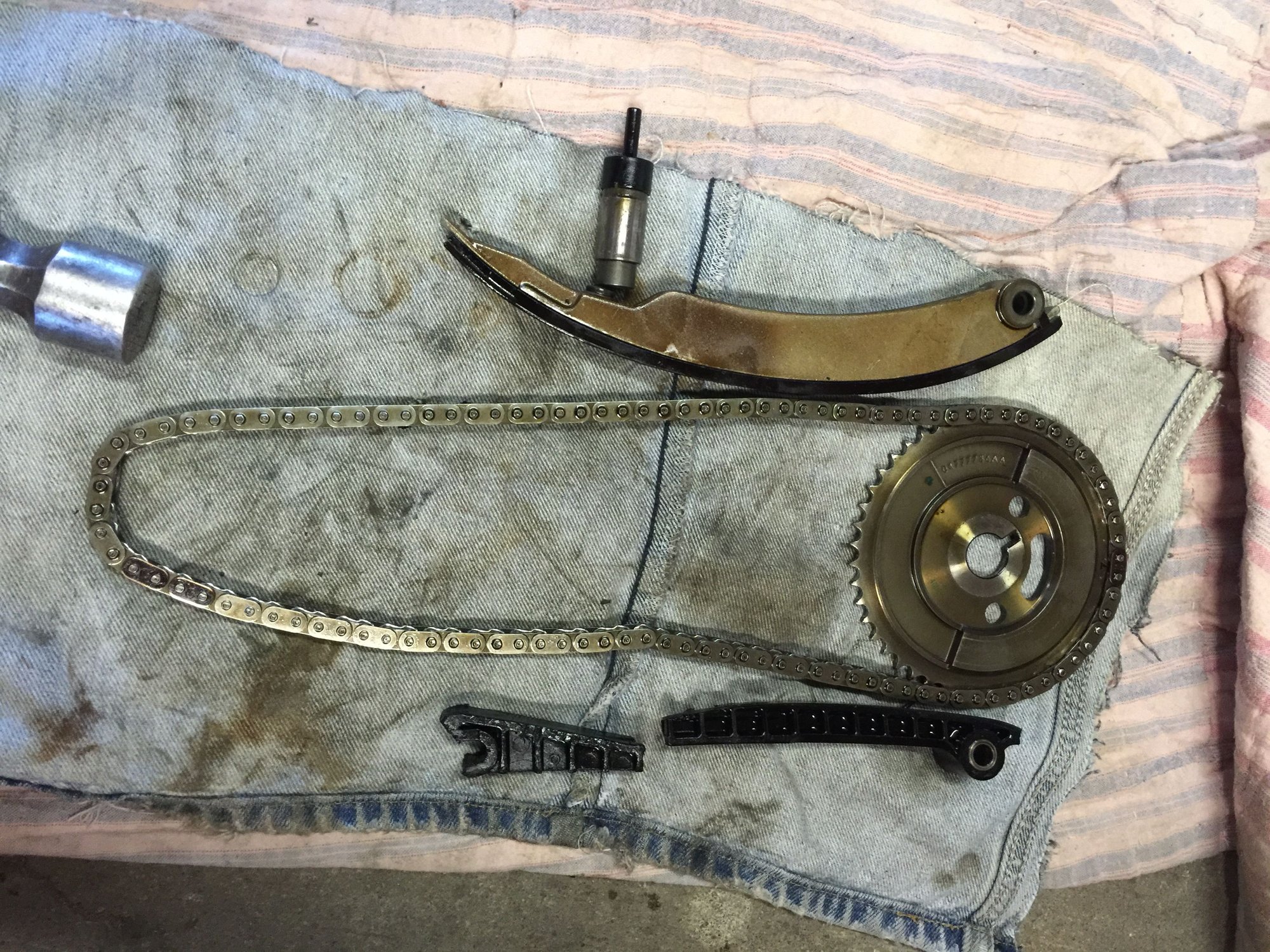

I'd say it's out of time. The tensioner seems to be frozen and the one guide is cracked in two. How do the timing marks go before you install the chain?

Yikes! Drain the oil, you're going to have to drop the oil pan. If you have the new tensioners there is a piece of plastic bonded onto the cracked piece that you're looking at that has likely circulated or attempted to through your oil. I found a large piece plugging my oil pickup tube. If you already bought the kit it should have replacement guides, a new chain and a new tensioner. When reinstalling match up the two copper links with the crank marks and the one copper link with the cam.
hopefully the motor isnt damaged because of the plastic in the oil. I'm going to put the motor back together and try to start it. I need to make sure the engine is ok. Then do the oil pan.

Do you have an R53 or R50? Honestly, what I believe made my car skip time was first the tensioner allowing some slack and ultimately breaking the same tensioner that broke on yours then a piece of it getting caught in the chain which encourages the teeth to skip. I can only assume this contributed because I found a few larger pieces on the valves that should not have been there at all.
