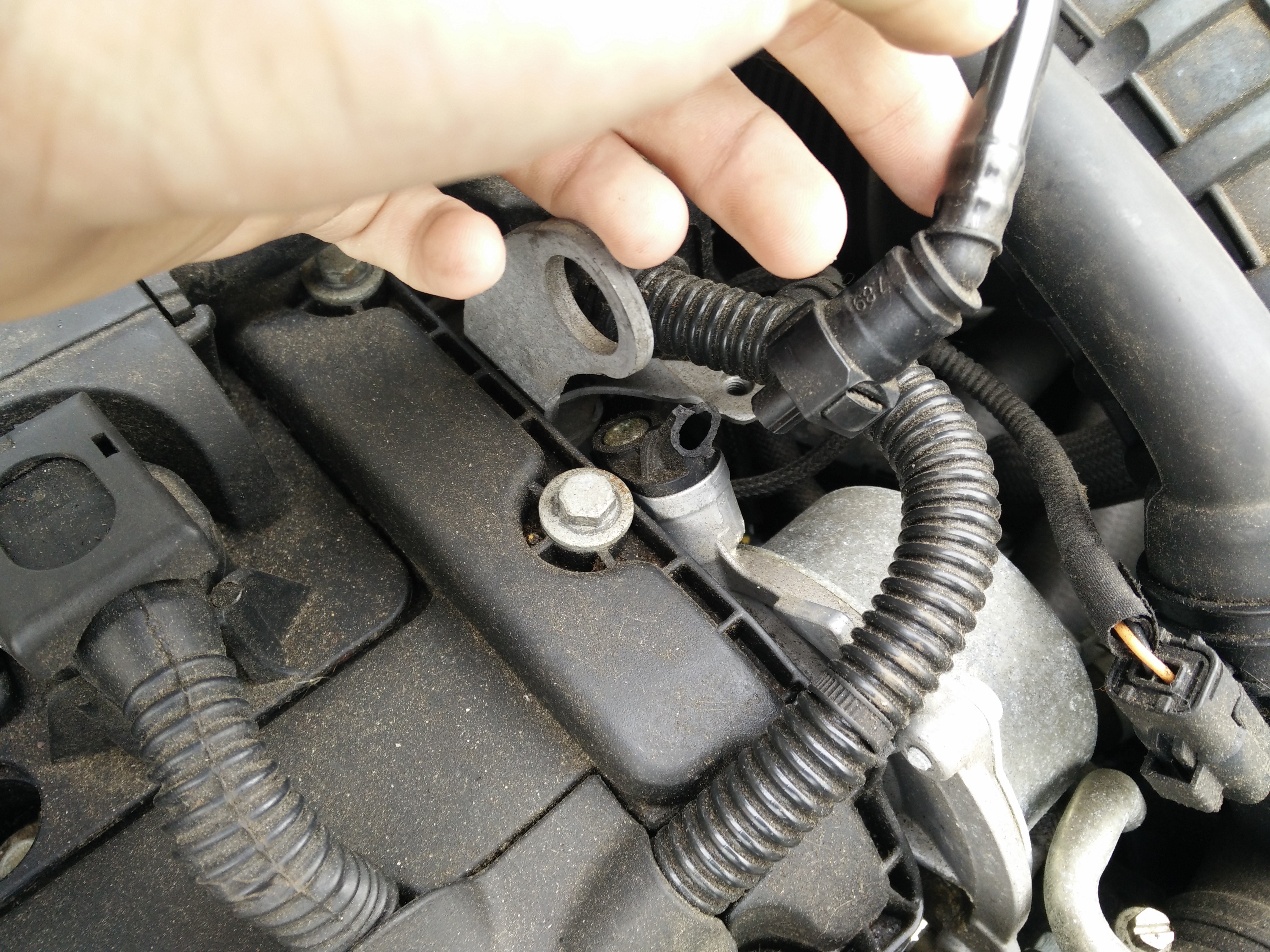

I need help to id and buy this nozzle! Anyone know where to get a replacement asap?!

Yikes , its part of the vacuum pump. Not a separate part.
You have the n14 ones/ 11667556919
http://www.ecstuning.com/Search/SiteSearch/11667556919/
DIY:
https://www.northamericanmotoring.co...ement-diy.html

I just need that black nozzle that come out if the pump . can you sell me just that individual piece?

Its not a separate part, you would either have to find a junk one and transfer, or buy a new one. And also lessen the chance of a vacuum pump seizure in the future.

The break looks quite clean. I would go to Home Dept and get a bottle of Loctite Super Glue Professional Liquid. As long as the break is clean this will hold tight. Picked up this tip from the Mazda Miata forum. Had a 1991 BRG that had quite a few broken plastic parts and a loose top seam and this product worked great. Just be sure that both parts are spotless and dry before gluing. This stuff drys very fast. I always keep a bottle around the house for repairs.

I fixed a plastic mirror with gorilla glue. Its worth a shot.

This is the vacuum line to your master brake cylinder. Do you really want to "patch" it?
