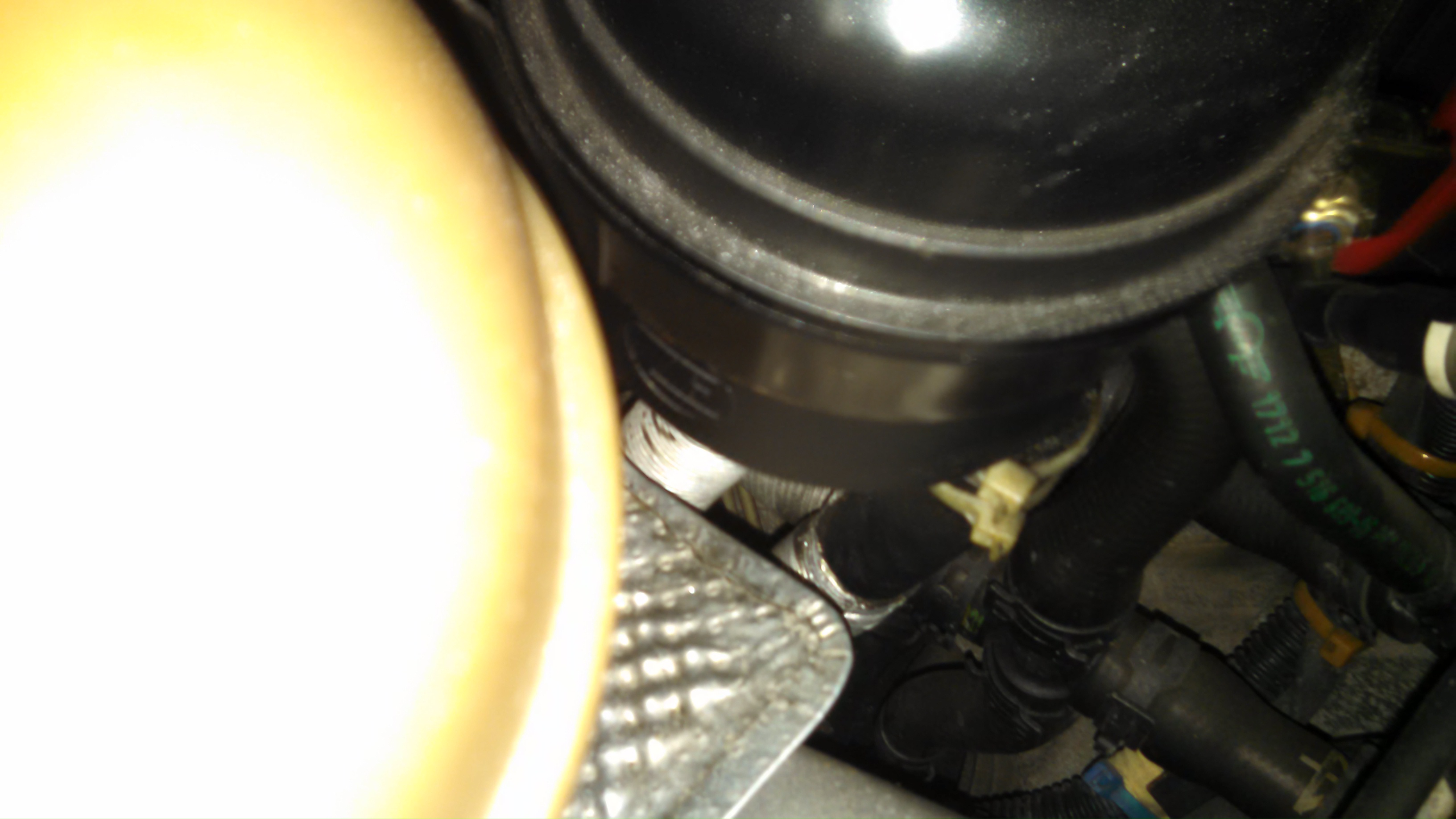

Mine looks almost just like yours, sorry for such a zoomed in photo, this is old. And im pretty sure it's PS. it looked green.

Someone's already replaced the lower clamp in your picture. Have you checked the two clamps on the reservoir in the engine bay? Mine were leaking and followed the hose down and made a mess down below just like the pictures. If the reservoir has the original crush clamps you can try replacing them with hose clamps. If that does not stop the leak, the kit above will. I just used that kit last week along with a quart of fluid.
It took a while to clean up the mess with rags!

Yeah I noticed the clamps were changed, I tightened them up myself when I developed an actual leak at the top ones. I'm pretty sure the mess is just from a past case of what I dealt with.

Mine was exactly like yours ..leaks at the top 2 hoses and trickled down below and made a mess ...What i did was use heavy duty Zip ties 1 above the original crush clamp and 1 below it on both hoses ...no more leaks after 1 year and 15,000 miles ....Easy and inexpensive fix ....
