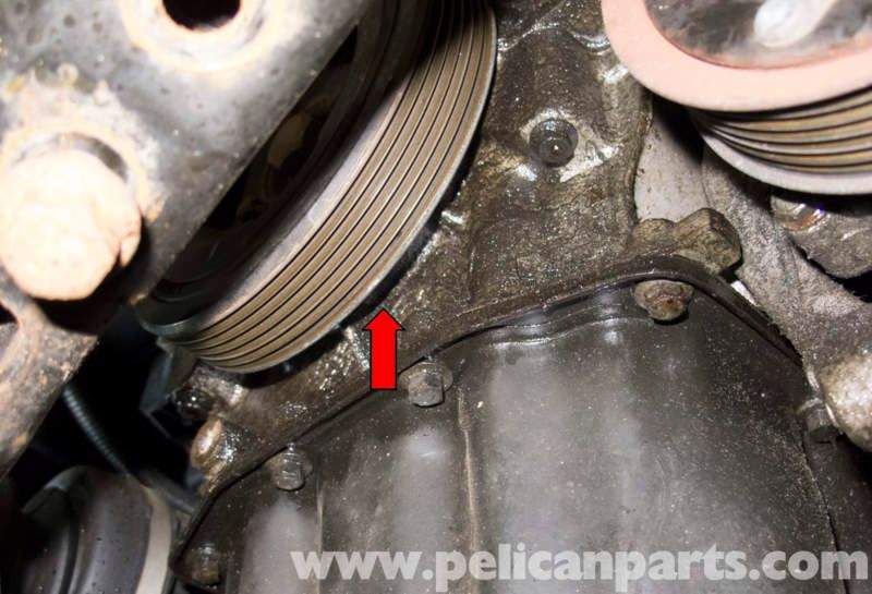

Usually oil that starts above and leaks down onto components makes them appear to be leaking. I'd look higher up to make sure nothing else is leaking. His is still the N14 JCW as they didn't go to an N18 until 2013. That bushing doesn't have any liquid. It could be the crankshaft seal or possibly the valve cover. Also, as said above it's a good idea to check the timing chain tensioners. If you find a leak at the right rear corner of the engine, check if the engine oil is being flung from the drive belt to the backside of the engine. On early engines, some timing chain tensioners would leak, however this problem was mostly dealt with under warranty mileage periods. It is still a good idea to check the tensioner to see if oil is seeping out of the sealing washer.
This is what a crank seal or valve cover leak would look like.
If you're having a hard time finding the source I'd suggest cleaning everything up and keeping an eye on it to see where it may be originating from.

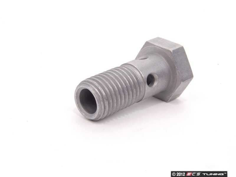

Is after drive I smell something and rev the engine and saw the white smoke. I came across this 1.8mm restrictor banjo turbo side for turbo oil feed line what is the benefit for this? Any idea?

For the tubro oil lines, like in our kit , they are not restricted ? 11657534454 KT
https://www.ecstuning.com/Search/SiteSearch/11657534454KT/
