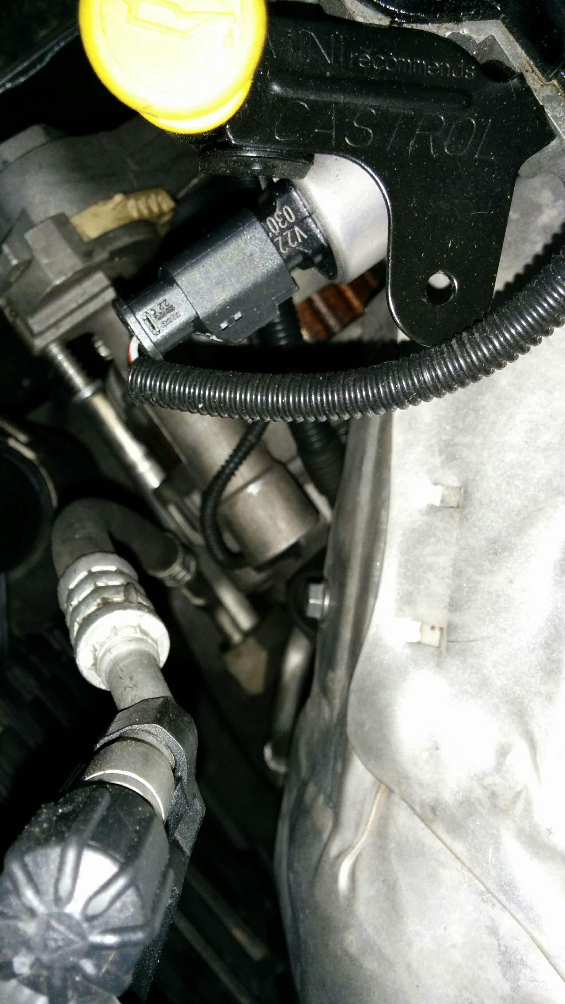

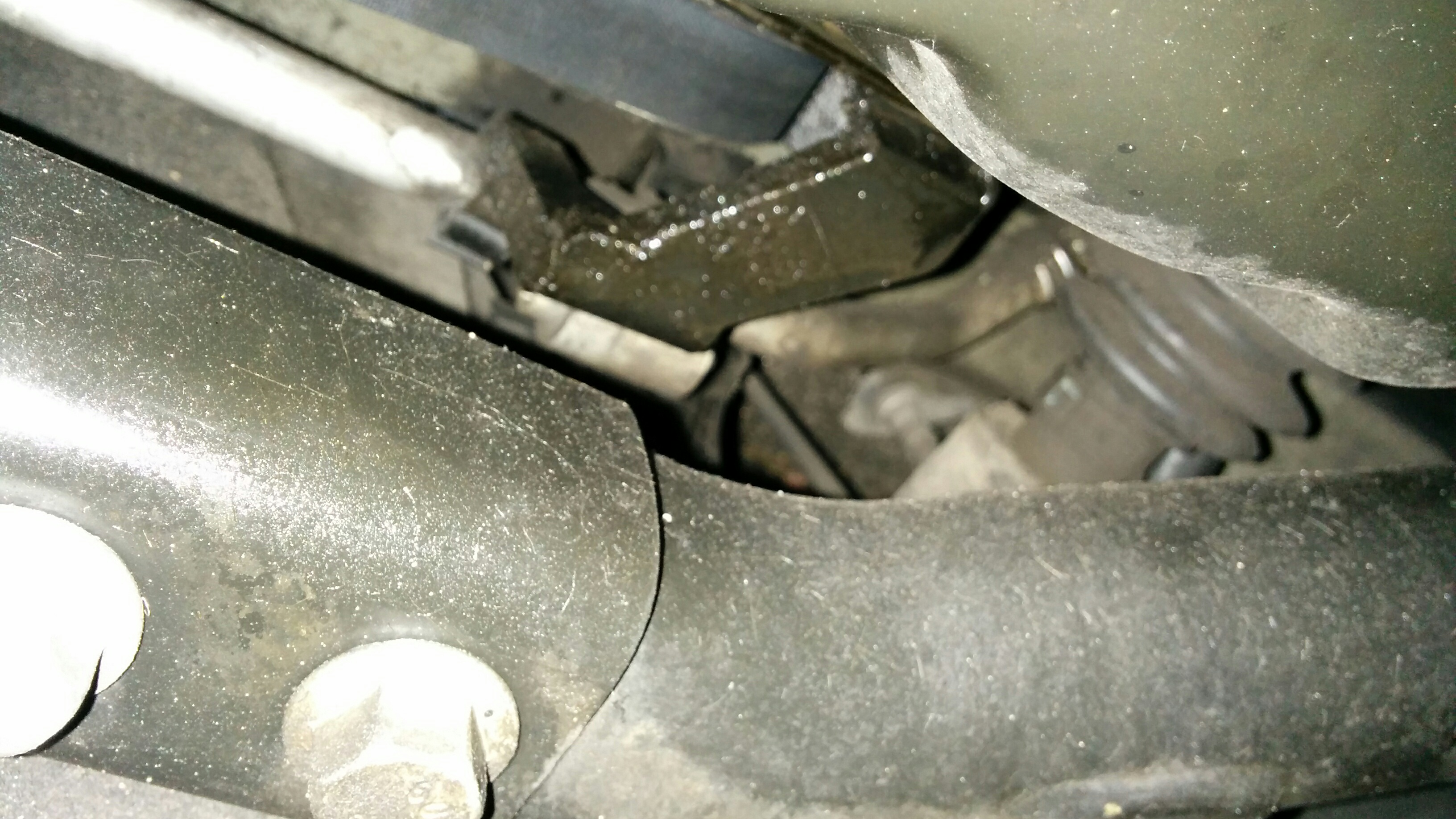

Hello all.
I am having some issues locating an oil leak on my R56.
Had my alternator ruined by an oil leak from the vanos selenoid but had it fixed a month ago.
A week after the repair, I found small oil puddles on the floor of the apartment garage and, later that day, also in my office garage. Thought it was a faulty selenoid but the area is clear of oil.
Leaving from home that same morning, I had white smoke, after about 20 minutes of normal driving, emanating from under the bonnet, with the distinctive smell of burned oil. This is a daily occurence now.
I am attaching some night pictures (cell phone flash without jacking the car up) in case anyone can pinpoint or give some advice on what to look for for a new fix.
Attached Thumbnails R56 Oil leak-img_20160112_202814.jpg   R56 Oil leak-img_20160112_202825.jpg   R56 Oil leak-img_20160112_202840.jpg   R56 Oil leak-img_20160112_202906.jpg   R56 Oil leak-img_20160112_202902.jpg

Looks like the oil pan gasket or the turbo oil lines or a combo of both.
I would clean up all that oil underneath and see where it leaks again as the oil might have been left over from the repair. Also check your oil level, you have a major oil leak, don t want you to run low.
Oil Pan gasket:
https://www.northamericanmotoring.co...an-gasket.html
Turbo Oil lines : Linked above also.

These cars aren't prone to pan gaskets as much as they are to oil migration from other leaks.
Chances are you need something in the area of a Turbo oil feed line, or oil filter housing seal, severely leaking vacuum pump.
We manufacture our own oil feed line that fixes the oil line leak for good unlike the factory MINI part which will leak again, and again.
DT TOL Super Kit
The vacuum pump if leaking is easily fixed as a DIY, but I doubt that much oil is from a leaking vacuum pump.
Does the turbo have oil on top of it? If you look down behind the turbo with a flash light do you see oil buildup, or leaks?
The linked kit comes with everything you need to fix the leaks from the turbo oil line/filter housing area. If you decide to clean up any mess to see where the leak is developing from please steer clear of power washers. I'm replacing a DME on a car due to someone powerwashing the bay.
